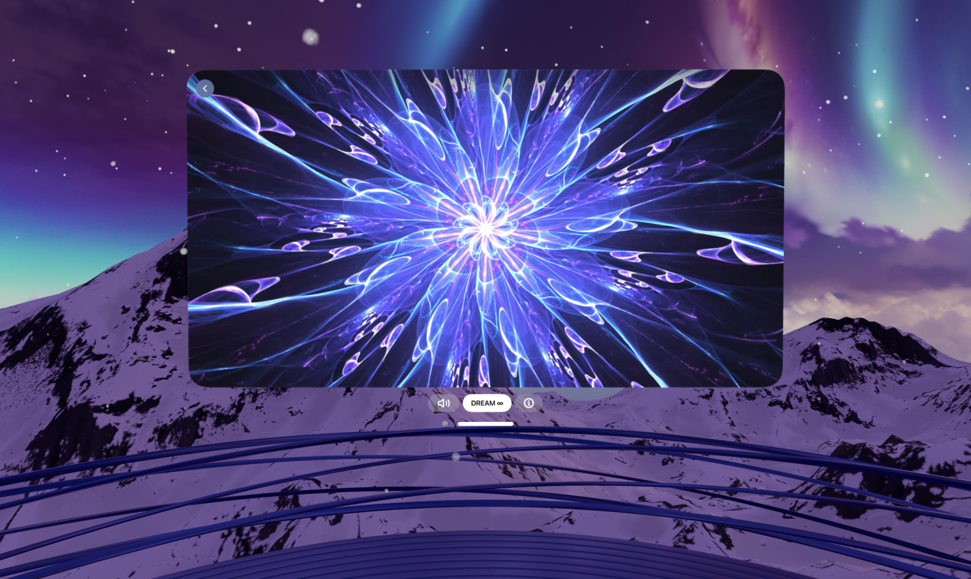

My app FLOW INFINITY: Dreams (check it out here: https://vizmystech.com/flow-infinity-dreams.php) will be available for Vision Pro at launch (I actually just submitted the first update for the app so hopefully that version gets approved in time). It’s an immersive meditation app that was developed from the ground up for Vision OS. We also developed an iOS version of the app simultaneously which gave us an interesting contrast and highlighted some of the opportunities… and limitations of Vision OS vs iOS.

• I LOVED creating the immersive spaces for the app. As I shared in another post, the ability to create and share worlds is one of the most intimate experiences I have had as a developer. The ability to (temporarily) change someone’s reality offers so many opportunities and I am already flooded with ideas for my next project. This is the area of Vision Pro that really has some potential and will offer a new creative challenge.
• I was actually really surprised how easy it was to develop for vision OS (once you get past the quirks). Apple has carried over a lot of the same building blocks from iOS which makes development for Vision OS feel immediately familiar.
• The chipset makes things MUCH easier as far as performance. One of the biggest problems developing for VR / AR headsets is balancing features with performance. Since the R1 takes a lot of the background processing weight from the M2, it leaves a lot more headroom to push things without worrying about dropped frame rates.
