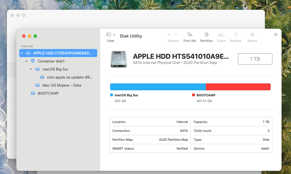

OK here goes, I'm currently running macOS Big Sur on a 21.5inch Late 2013 iMac (patched) but it's running slow and would like to revert to the latest OS for my iMac which I believe it's Catalina. I've attached a screenshot of the disk utility and would like some help on what to delete for a clean internet install of Catalina.

In your title you specifically said "factory reset" -- if that's really what you want, than let me just state up front, quite clearly:
* * * This will delete everything. All gone. Zorched. Delorted! Buh-bye, precious data! * * *
So yeah... if there's anything at all on either your macOS partition or your Bootcamp partition that you want to retain, you should perform appropriate backups before doing this stuff. That said...
If you don't already have Catalina installed, I would recommend just doing that update from the Mac App Store first, as the final results should be cleaner.
Next, you need to boot from the Recovery Partition, by rebooting while holding down Command-R. (If you're using a wireless keyboard, you're probably going to have to scavenge up a wired keyboard to make this part work; wireless keyboards can't always get you there.) Once you've booted into Recovery mode, open Disk Utility, hit the "Erase" button at the top of that window and change the partitioning scheme to a single partition. This will merge that 400GB of Bootcamp partition space into the macOS partition, (giving macOS the full 1TB of space) and wipe whatever data you currently have on both partitions. Once you've completed the partitioning, you can exit Disk Utility and reinstall macOS from the Recovery Partition.
As an aside, you mentioned "internet install": I think you may be referring to the "macOS Recovery mode over the internet" option available via Command-Option-R on Macs which support that, but it has been my experience that using that mode doesn't actually pull down the latest compatible major version of macOS; it only pulls down the latest patch to the OS version which was most recently installed on that Mac, even if the hard drive has already been wiped. (Reason? Oh, I would guess it's something-something-firmware-something.)

I believe the late 2013 iMacs shipped with Mojave, not Catalina.
Your screen capture shows SATA, meaning you have a mechanical hard drive. Mojave was the last OS to support Mac OS Extended as a file system. While APFS will work with mechanical hard drives, it wasn't written for them, thus it does degrade performance. APFS is best for SSD drives. Please note that the full Mojave installer will only format your drive in APFS, upgrading from High Sierra allowed you to keep Mac OS Extended as a base file system.

OP has a 2.5-inch HDD. Nothing that you do with that hard drive will help much for speed, except upgrading to an SSD.
I just rebuilt that version 2013 iMac, added an m.2 blade SSD, which transformed that iMac. I also maxed out the RAM to 16GB (had 4GB before the upgrade). It's not an upgrade for the faint-of-heart, requires completely removing the logic board, the RAM and PCIe slots are both on the back -- but the results made it worth the effort.
