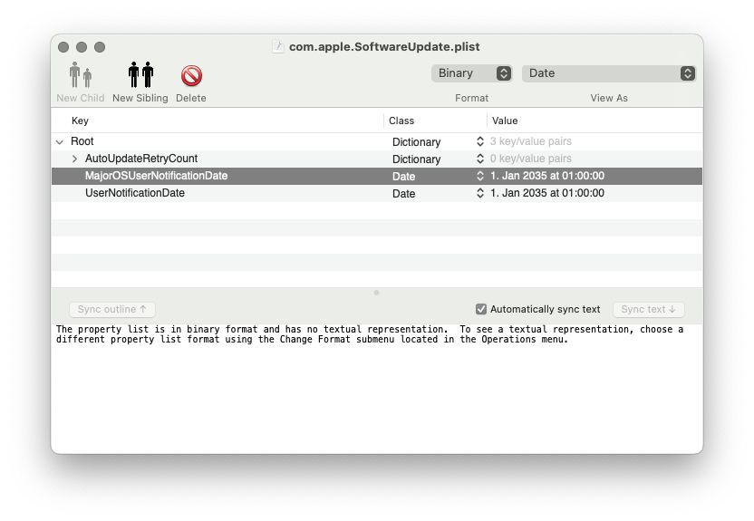

Yes, if it’s for this part...
Code:
defaults write com.apple.SoftwareUpdate UserNotificationDate -date "2035-01-01 00:00:00 +0000"
defaults write com.apple.SoftwareUpdate MajorOSUserNotificationDate -date "2035-01-01 00:00:00 +0000"
...it just didn't work. Update notification reappeared just one day after. Even with the 2035-date correctly written to the prefs-file.
So there must be something else. At least this setting does not seem to have any influence anymore. As little as blocking the updater from accessing the internet via Little Snitch.

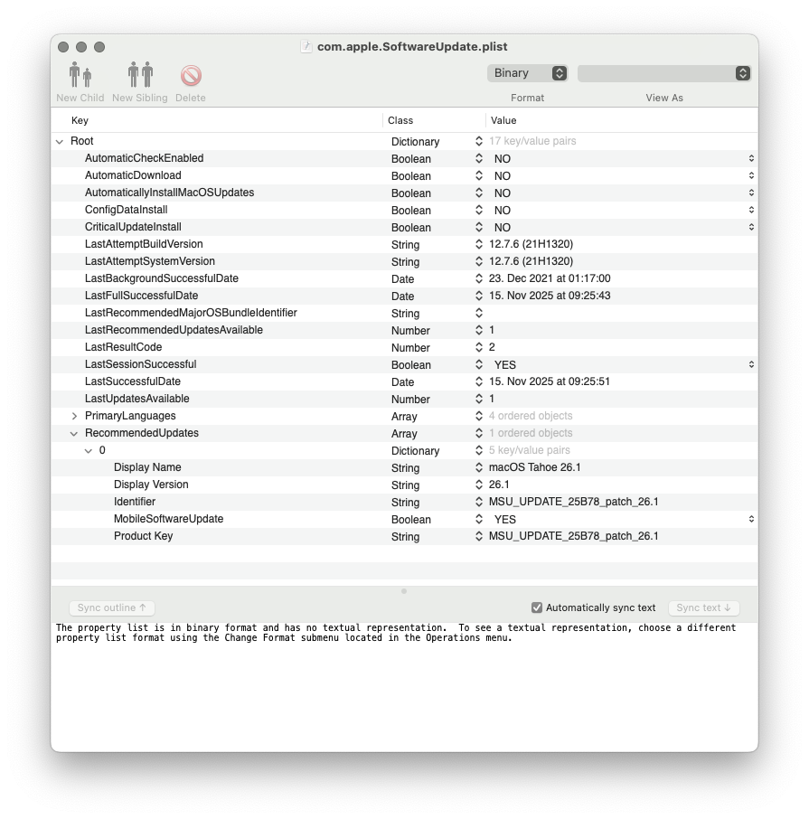

So there is another plist-file for SoftwareUpdate not in the user- but in the system library.
This is, what my settings are:
This is the point, where i really do not get, how things work, cause
a) the App is (should be?) blocked from entering the net in the first place
b) the prefs-file clearly says "do not automatically check for updates"
But, disregarding all that, the annoying sh*t keeps reappearing.
Are there any edits to be made to the plist shown above which could permanently avoid things from happening?
Thanks!
