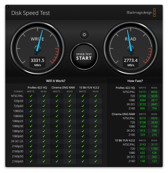

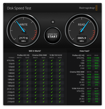

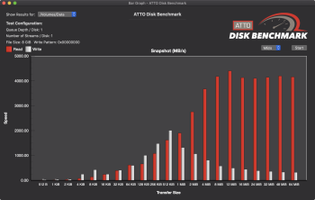

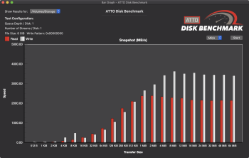

I bought this drive to try out, it's certainly a compelling form factor for the MP. It's basically a RAID 0 setup with an 8x PCIE 3 interface.

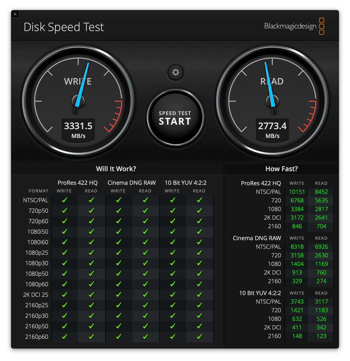

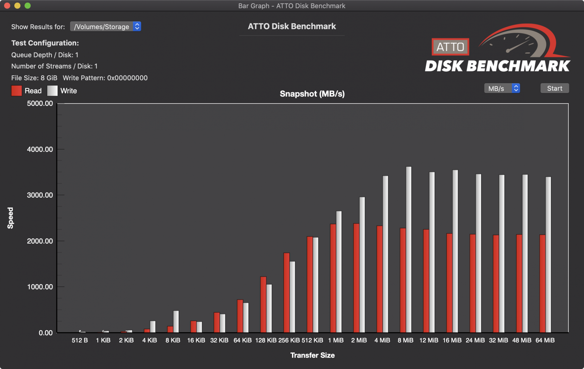

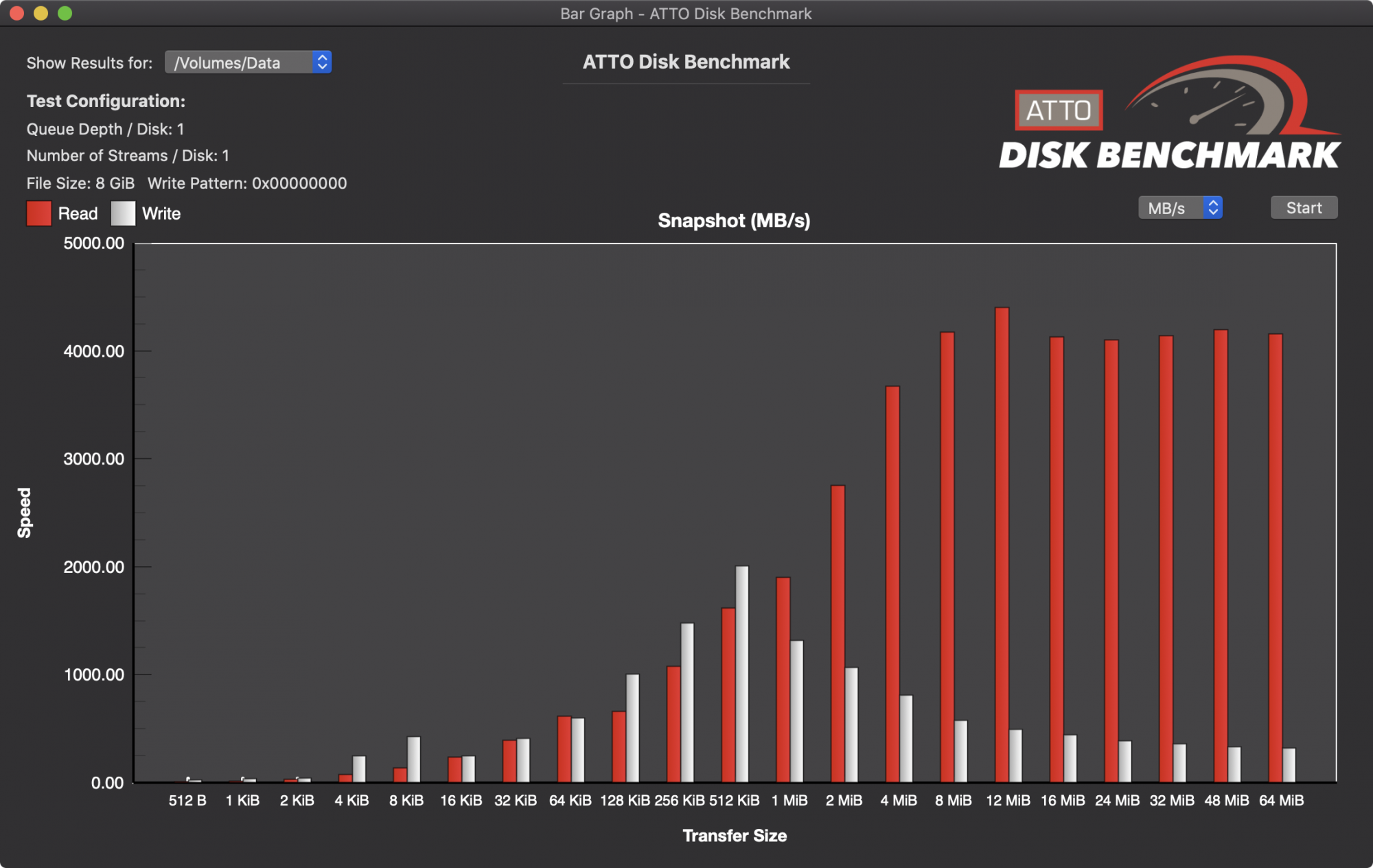

For starters it works without issue in MacOS, which is obviously a plus! My current setup is 2X 2TB 970 EVO Plus in software RAID 0. It's easy to compare these two because they're so similar. Here are some results:
WD AN1500
2x 970 EVO Plus RAID 0
So as you can see reads are extremely fast and consistent on the AN1500, but writes are significantly worse than the 970 EVO Plus setup. There is definitely a tradeoff with this SSD. Anyway hope this helps someone!

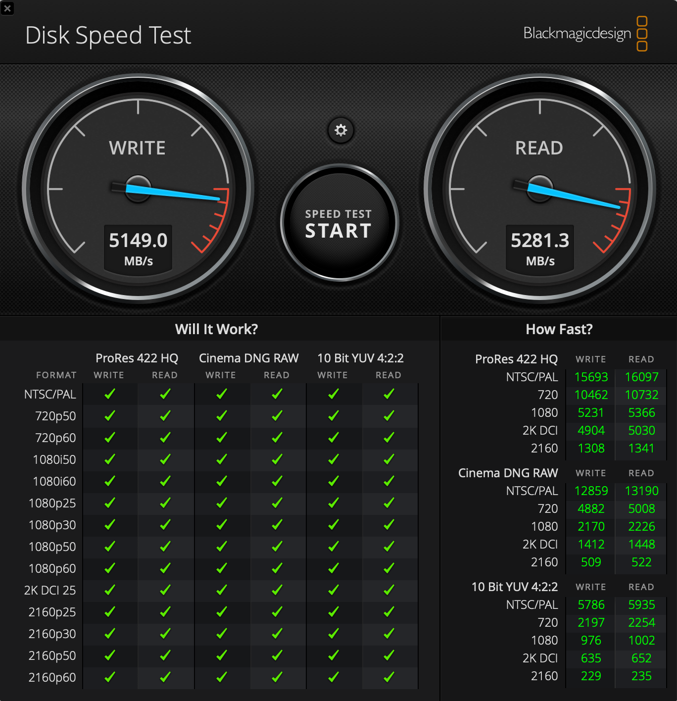

For the OP speed test, I don't know what kind of Mac he's using and it looks like an old Mac unit as that's definitely not what I'm seeing with my 2 x 2TB Samsung 970 Evo Plus in RAID 0 with the Sonnet m.2 PCIe card. I have 4 sticks in there but I separated them into two different RAID 0 setups. I don't need the full speed of all 4 sticks.

Your speed test for the 2 x 2TB Samsung 970 EVO Plus is exhibiting poor performance than what they are capable of as you can see in my own test of the same card type and capacity.
