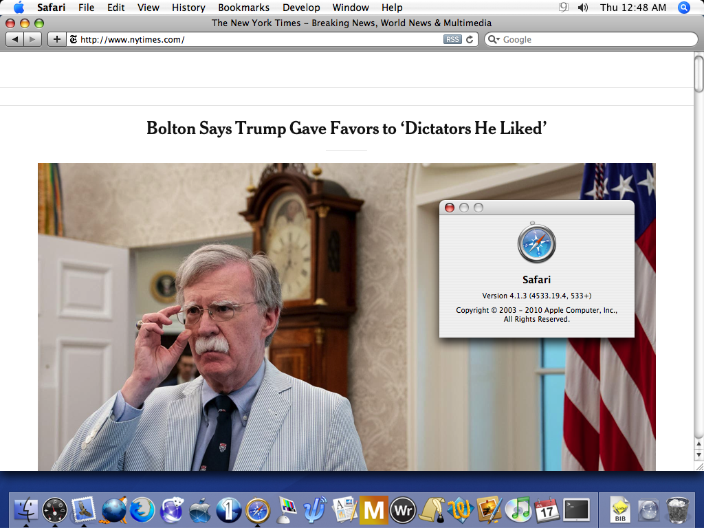

I’ve tested webone with Safari 4.1.3, and it was able to access sites that were previously unreachable due to lack of compatibility with modern security cyphers. Just thought it was interesting.

I ran the client on Windows 7, and connected to the host with safari 4.1.3 on tiger.

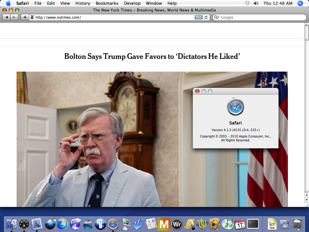

Suddenly I have the web back on my iMac G4, no matter the browser. It's kind of a funky solution to the TLS nightmare, but it works! This plus a little UserAgent tweaking and suddenly I can load most of the web again in Safari 4.
