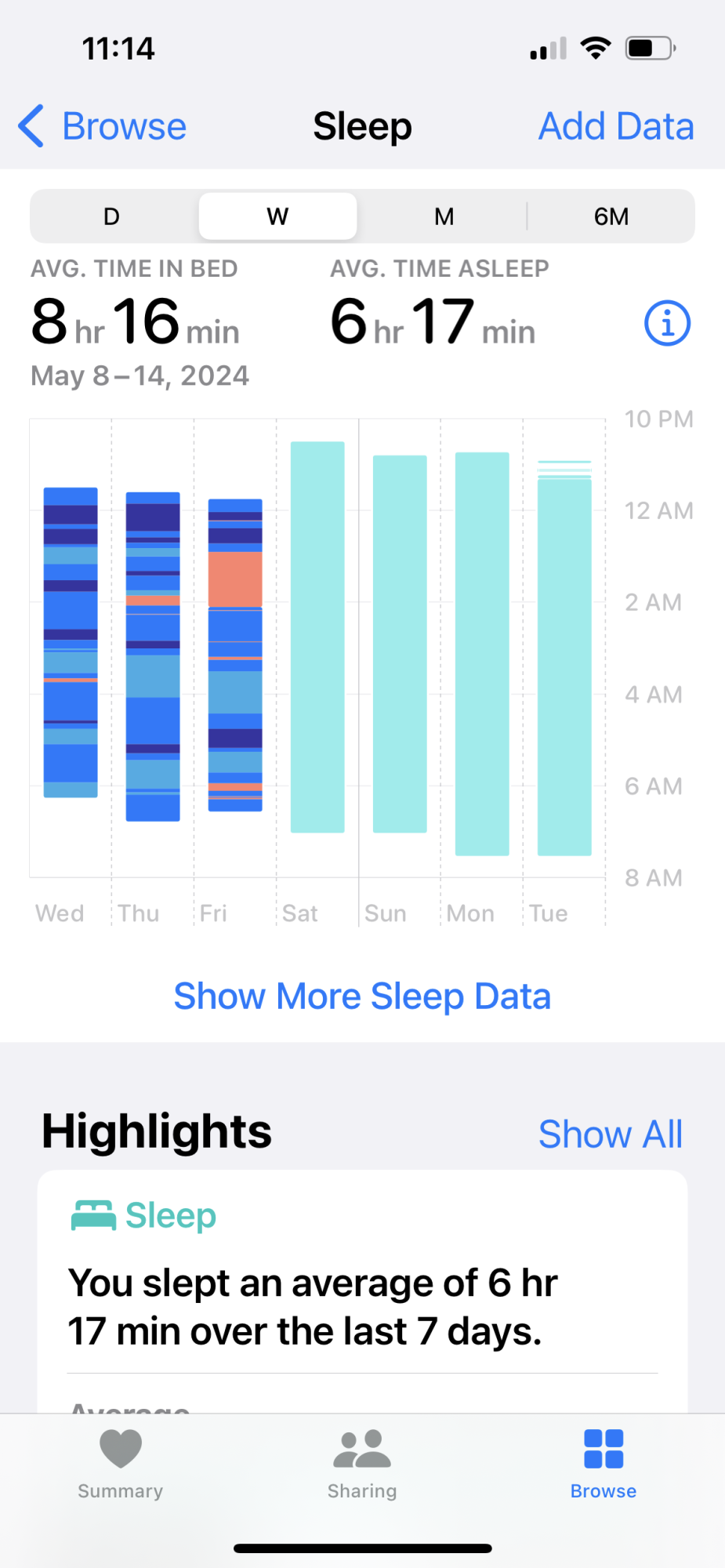

My Series 8 45mm has started acting up. Of course it’s about a week out of warranty coverage.
I started using a new watch face, maybe coincidental, but soon after wrist detection seemed to stop working. It sometimes works but then heart rate sensing seems to stop working. I’ve unpaired and set up as new twice. The first time fixed wrist detection but broke heart rate, the second time fixed heart rate but same to have broken wrist detection.
If I open the heart rate app it will sense for a second or two, then the watch locks.
Are the sensors going bad?
Also I should add that detailed sleep tracking seems to have stopped as you can see in the image.
If you un-paired and set up as new, without restoring, then it does seem like it could be a hardware issue. Did you do the 10.5 update? If not that might be worth doing.
Reactions: johnc22
as above - update to the latest OS, and setup as new, not restore.
If the problem persists, contact Apple. Even if it is a HW issue, they should be able to diagnose it and then you can take appropriate next steps
Reactions: johnc22
