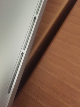

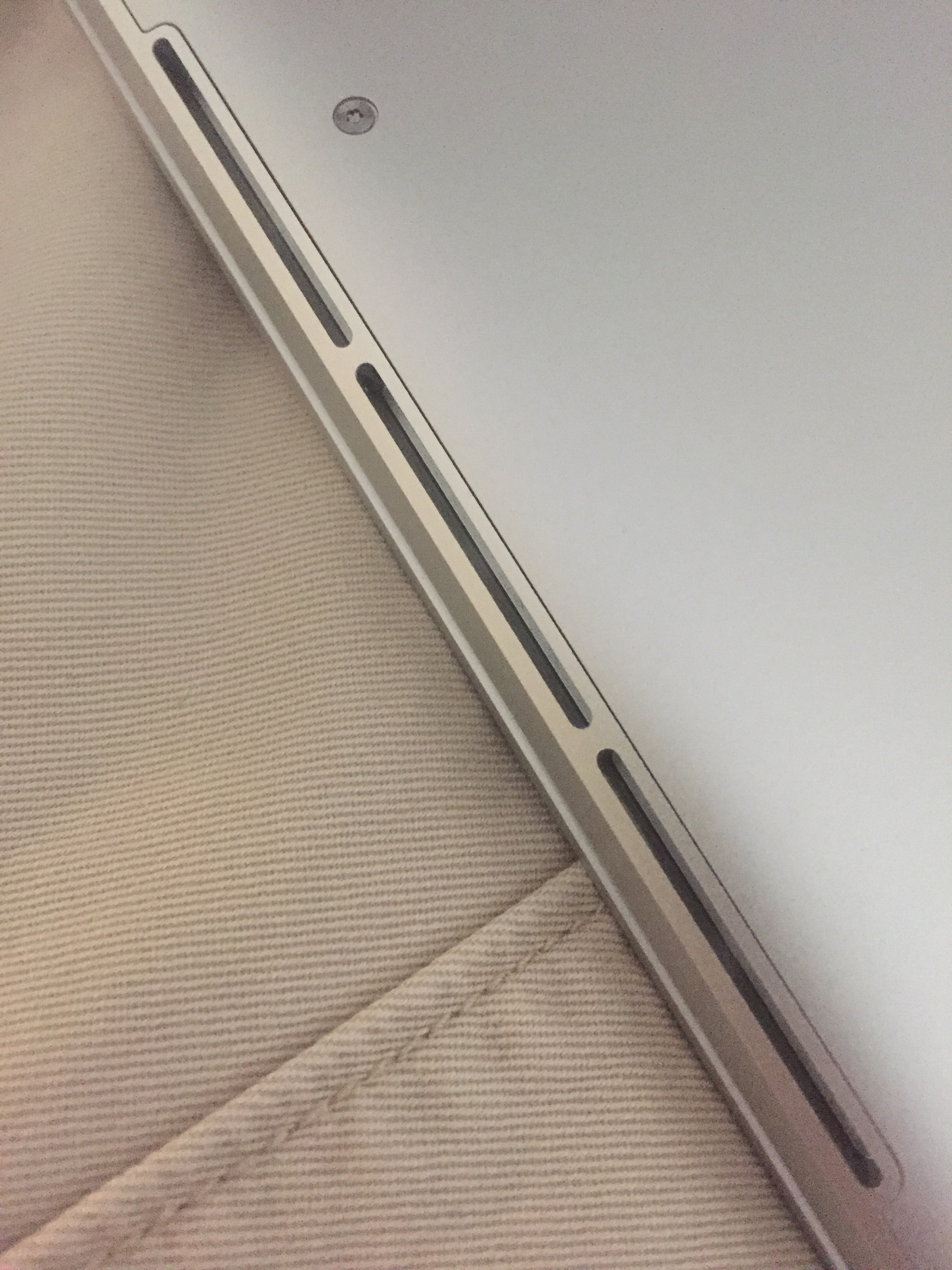

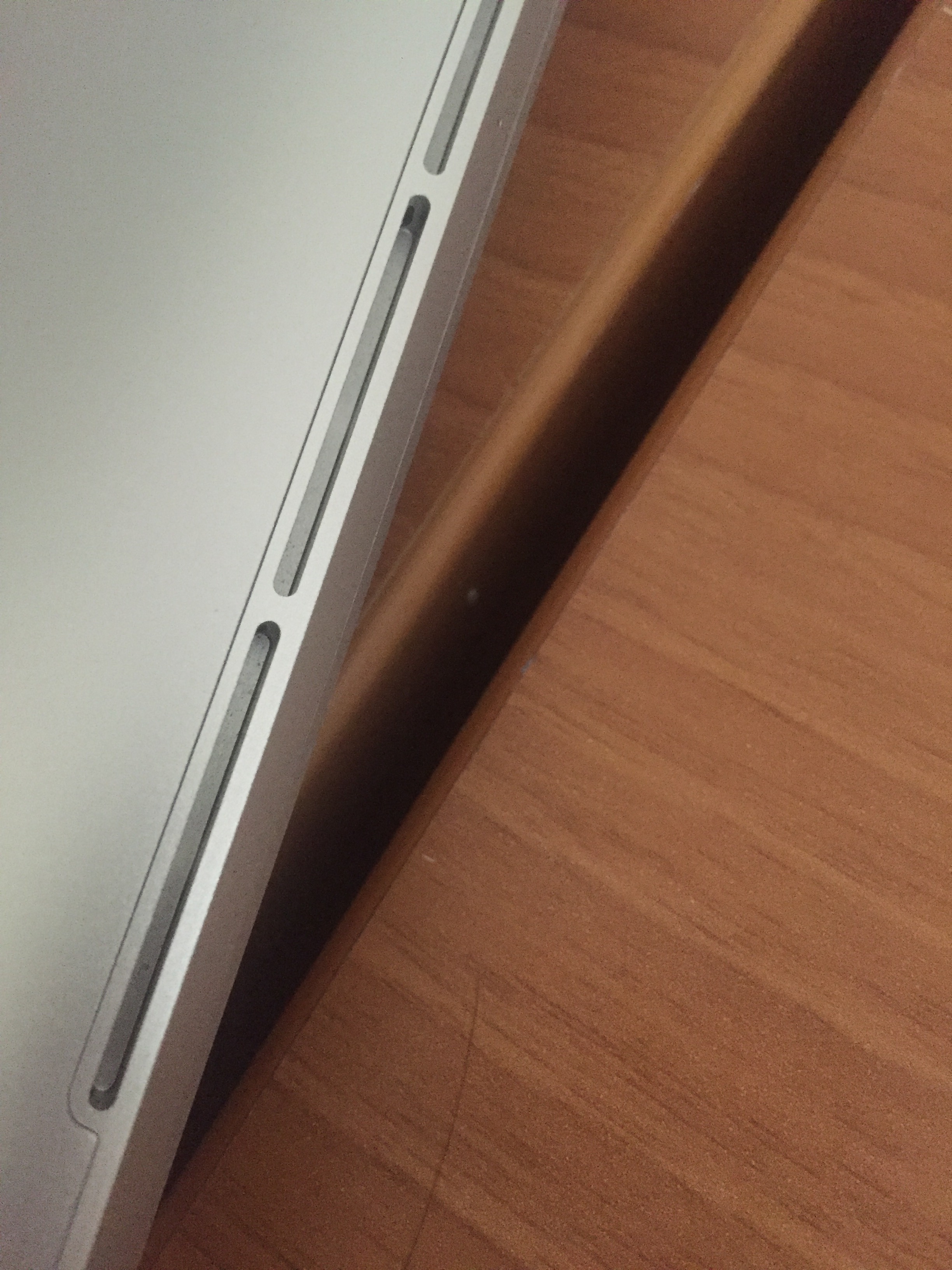

the other day I noticed the screen on my Retina Macbook Pro seems to be sticking off the side. If I rub my finger on the side of the unibody with the display shut my finger hits the display on one side but the other side I can see the tiniest sliver of the unibody. I feel like I am doing a terrible job of explaining what is going on so I will attatch some pictures. My laptop has never been dropped or put in a bag or had stuff stacked on it so I'm not sure what caused this.
