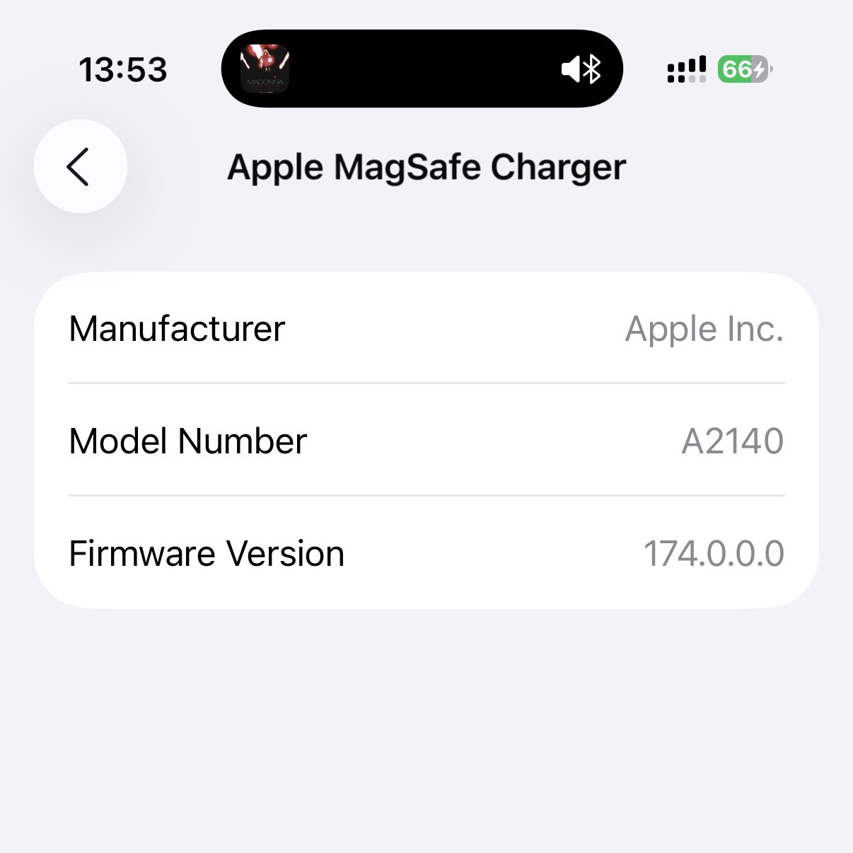

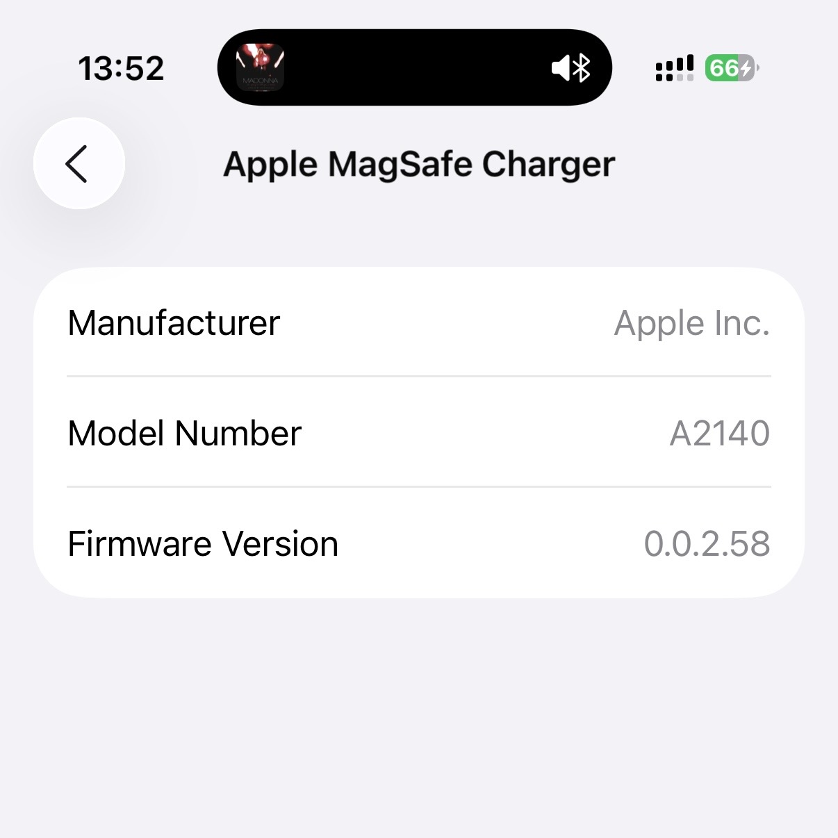

Hi! I have 2 A2140 MagSafe Chargers both with different firmware versions.
I’m having charging issues, both say my iPhone 16 Pro is charging but it actually does not charge.
Out of curiosity, I checked the firmware version and was surprised to see them both on very different versions.
I can’t find an Apple support document showing what the latest firmware version is for this model… any ideas?

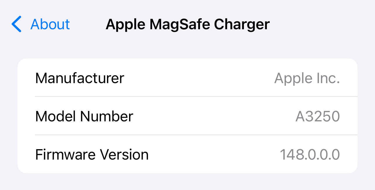

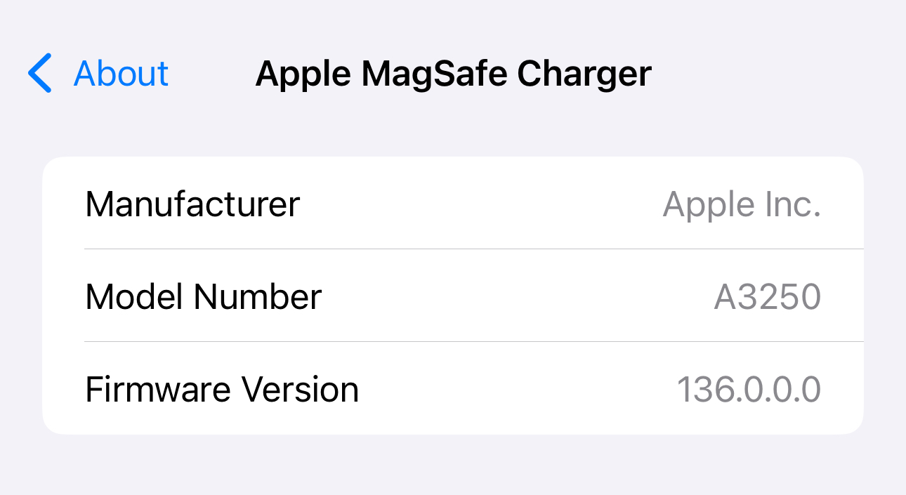

This is what my 25 watt version is showing I can’t find my 15 watt version to compare.
I don’t think this is the latest update. It’s charging my iPhone 14 Pro Max. I wonder if the latest firmware requires the latest iPhone.
I also have a 25w Version which states is a A2580 with Firmware 148.0. Hardwareversion REVA
For the original charger (A2140), the latest version is 258.0.0 from May 2023.
For the new 25W charger (A2580 or A3250), the latest version is 148.0.0 from last week.

Thank you. I did find out that plugging the charger into my MacBook will force it to update so they are both on the latest 258.0.0.
Still for some reason neither charger is working properly, the phone says it's charging and gets warm but the percentage never goes up and actually goes down over time. I believe this started with one of the recent iOS updates, 18.5 or 18.6 possibly. Happens with both chargers and both phones (both iPhone 16 Pro). My 3rd party MagSafe charger in my bedroom works fine.
