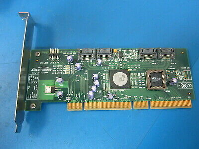

Hi all,
I'm trying to get my hands on one of these or something similar to https://www.firmtek.com/seritek/seritek-1v4/ or https://www.ebay.com/itm/254669345065. I looked up the vendor and device ID. It's a SiI 3124 PCI-X Serial ATA Controller. They appear to be Mac compatible (or at least flashable?) but I can't find anywhere selling them. I'm hoping that'll allow me to get more performance out of my SSDs than with standard PCI.

If you don't need bootability, you can buy a generic Sil3124 card (either PCI-X or not) and install the Mac driver for it.
But you mentioned SSD. So you probably use it as a boot drive.
You can swap the BIOS chip to the ones the Firmtek's firmware supports and try flashing it. I think the card from Hong Kong on eBay uses this method.
There are PB3124 cards that you can swap the BIOS chip easily, no need to use a solder iron.
All PB3124 cards are sold very cheap with eye-watering shipping out of the US...
[not my item]
Interesting. Yes I do need bootability. Where would I find the replacement BIOS chip?
If you flash the card from a PC, the chip can be one of these: AM29LV040B, MX29LV040, PM39LV040.
If you want to flash the card from a Mac (using WiebeTech's flasher), only PM39LV040 can be used.
[Correction: WiebeTech's flashers only work with sil3112 and sil3512 cards]
You can buy the chips from many sources. I bought my PM39LV040 from aliexpress. Digikey and Mouser probably have them too.

The sure way is to flash it from a PC, using a PC flasher. Here is a successful attempt:
I'm afraid you will have to find out which PC flasher to use. Because I don't have a PC, so I didn't collect info
about it. My original plan was using my Mac to do the flashing by installing a chip socket onto my Sil3512 card, put
a PM39LV040 in and use WiebieTech's SIL3512 flasher to flash SeriTek 2se4 firmware to the chip, then, move the chip
to an Sil3124 card. But I couldn't find an Sil3124 card that fit my budget. So I abandoned the project.
Or you may try this Mac OS 9 flasher (sign-in is needed to see the download link):
It doesn't have to be PM39LV040 if the flasher you're using is not WiebeTech's. Anyone of the three chips should work.
Firmware for these cards are very old. You may encounter problems with some new drives not recognized or hang, etc.

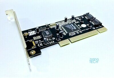

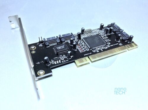

eBay? $40 is a decent price: https://www.ebay.com/itm/132581321334?hash=item1ede766a76:g:57kAAOSwTcphaK52
Also…
MODS, NOT MY AUCTION(S)!
Also…
I already have one of those. I'm specifically looking for a 64bit PCI SATA card. Those auctions are for 32 bit cards.
