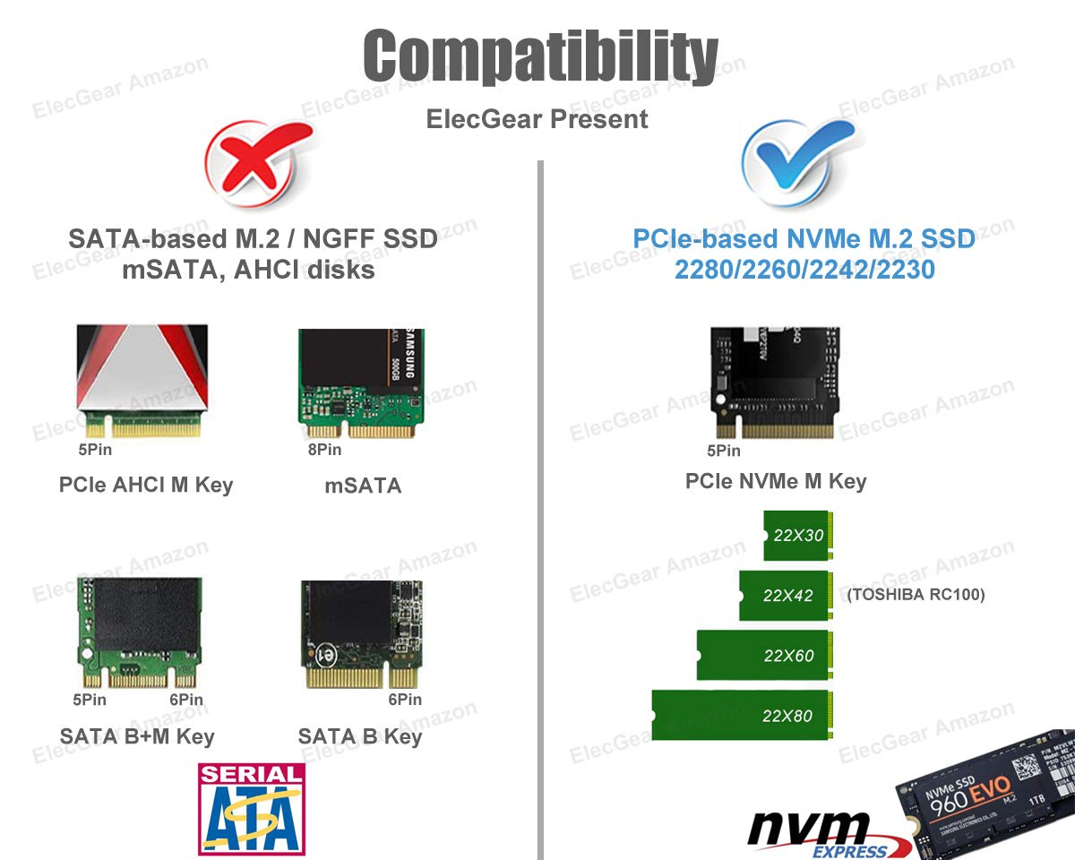

It looks like you bought the wrong case. AHCI is not the same as NVMe.

You bought a case that fits an "nvme" drive, but you DO NOT HAVE an nvme drive.
That means it ain't gonna work.

What I have noticed is that it says current available 500mA, Current required 900mA (so I'm guessing this is the problem).
No. This is the problem.
Note that AHCI is in the incompatible column.
