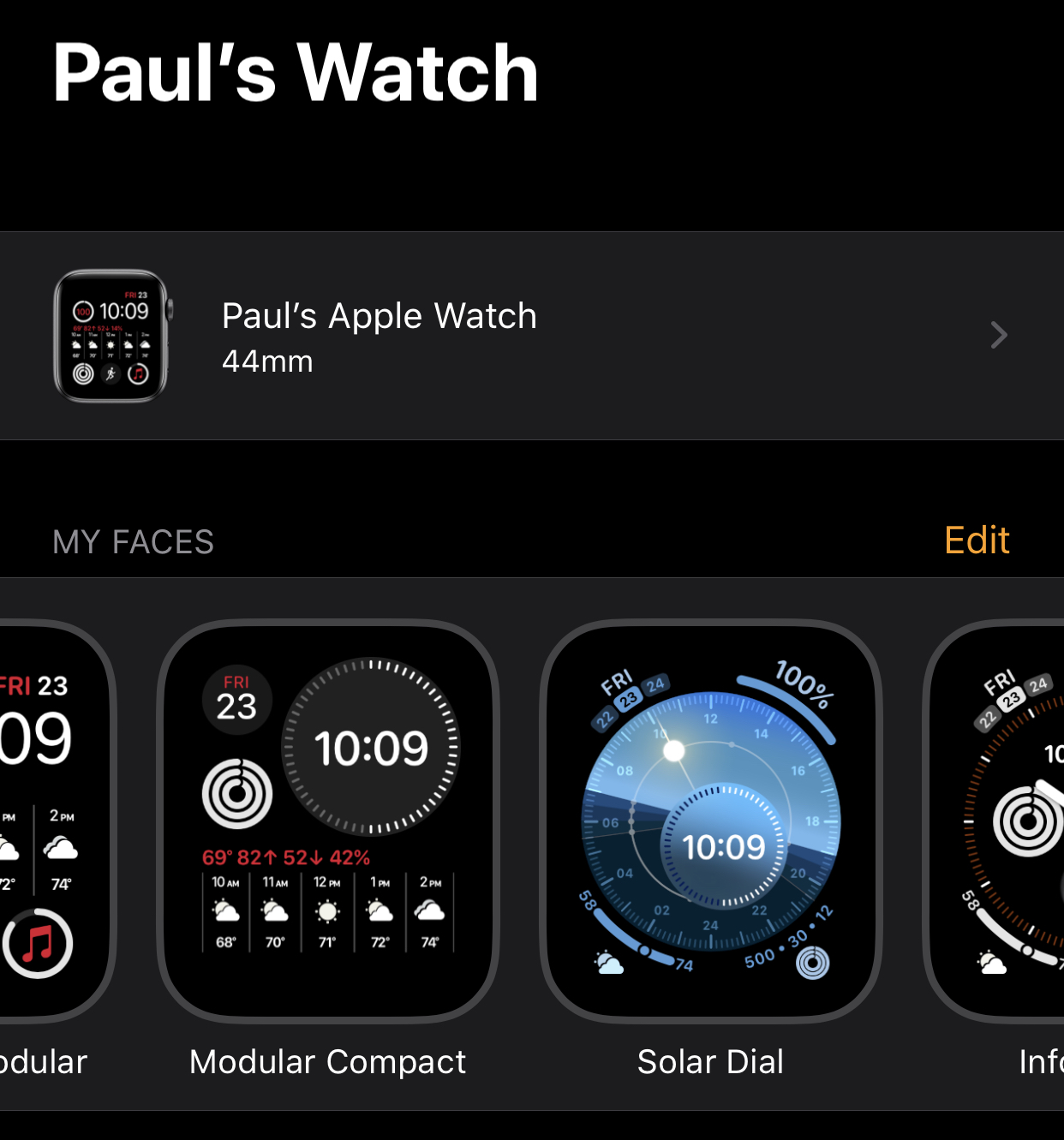

I have used a variety of watch faces. I have 4 favorite ones but I stay on the Infograph Modular most of the time.
My favorites: Infograph Modular, Modular Compact, Solar Dial, Infograph.
I've used my favorites album as a wallpaper once - but didn't really notice much of a battery life change, just that I used my watch less because it had less info on it.

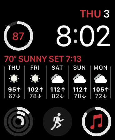

I much prefer Infograph modular. I have Carrot Weather doing a 5 day forecast with exercise options on the bottom for convenience.
