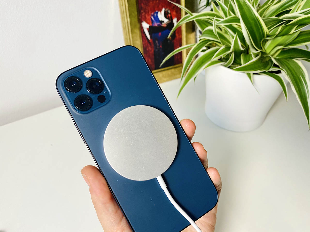

So I purchased a magsafe puck. Place it in an anker 'fast charge' usb hub and used Watts Lite to test - a whopping 3W delivered to the phone.
Tested again with my iPhone 11 pro plug which clearly supports up to 18W... a whopping 7W delivered to the phone.
Just how can I get the 15W as advertised? Oh to shell out for an Apple 20W charger and toss my others in the bin. How environmentally friendly!
Is this just me? Has anyone tested the magsafe puck with last year's Apple 18W charger? What were your results?
I tried the 18w brick and got 15.75w wireless on my 12 Pro using the Amperes app. The 20w brick yielded the same results. So no need to shell out extra money.
Something is wrong then because im not getting anywhere near that - 7W tops for me with the 18W brick. Very curious.

Yes but regardless of what they are recommending, the iPhone 11 pro came with a 18W brick.. the Magsafe tops at 15W, so I would expect to see something close to the full 15
[automerge]1603647643[/automerge]
So the puck can’t fast charge?
iPhone 11 Pro allows for only 7.5W wireless charging. You would need the iPhone 12 to support the advertised charging speed and capacity. The iPhone 11 Pro only supports up to 18W wired. You can Google “iPhone 11 Pro wireless charging speed” and decide for yourself with the info. But you won’t ever get 15W wirelessly on the iPhone 11 Pro.
erm I’m using an iPhone 12 pro,all I said was that I used my 18W iPhone 11 Pro charger from last year and I’m using Watts Lite to measure
The video I linked above says you have to use the Apple ONLY 20w brick to get fast charging on MagSafe. 3rd party bricks won’t work. Here’s the video again.
Right I’ve seen that. What a scam.
