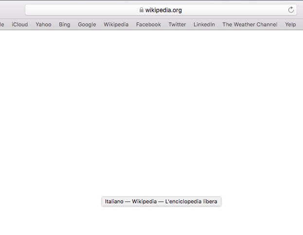

Hello all,
Would appreciate some help. Have trawled the Apple support forums, and done what was suggested, to no avail.
Symptoms:
Both Safari and Chrome, AND the App Store are affected.
Firefox working flawlessly, which has me all sorts of confused.
When trying to go to any website in Safari or Chrome, the pages stay white/blank. The underlying data is 'there', as evidenced by the screen grab of the Wiki homepage, but nothing I do fixes it (the grey pop-up is over where my cursor is resting, and is pointing to an underlying link).
Similarly, the MAS stays blank on all pages. I am told there are two updates, but irrespective of which tab I select, the MAS will not load anything on the contents pages, and remain blank.
I have cleaned out the cache folders to Safari, Chrome and the App Store.
Wiped the plist files.
Played around with the date settings.
P'ramm'ed.
Tried the guest account, and safe mode.
Rebooted and restarted
Killed appstore related processes in Activity Monitor.
All as per suggestions in the various help articles, all without any change.
Her work forces her to run outdated Flash and Silverlight to access work websites. Firefox may also not be updated, as a result. Could Flash etc. be involved?
Running El Capitan macOS 10.11.6.
Hoping someone can think of something to try - never had a Mac do something that couldn't be solved with a bit of digging.

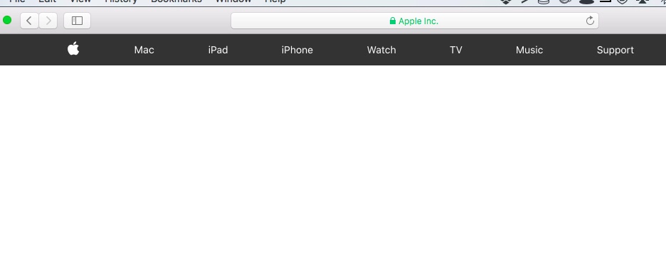

Here be what Apple.com displays as. As with before, there are active elements below the white, that are simply not being displayed.
Oh, and just for fun - Messages isn't working either. Can access its preferences, and can confirm she is signed in, but cannot get the Messages main window to display...
Something very odd going on here. Getting tempted to upgrade, to see if that does the trick - but given that the App Store is misbehaving, not sure how I would do that either!!
