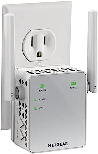

It may not be what you want, but for a cheap solution buy a wifi extender with ethernet port. You can find them for about $15 online.
Plug it in close to your G5, attach ethernet cable, done.
This is my preferred solution because the Wifi implementation on the G5 is obsolete and I'm running a Wifi 6 router in my home. Bluetooth if you need it can be added with a USB dongle.
