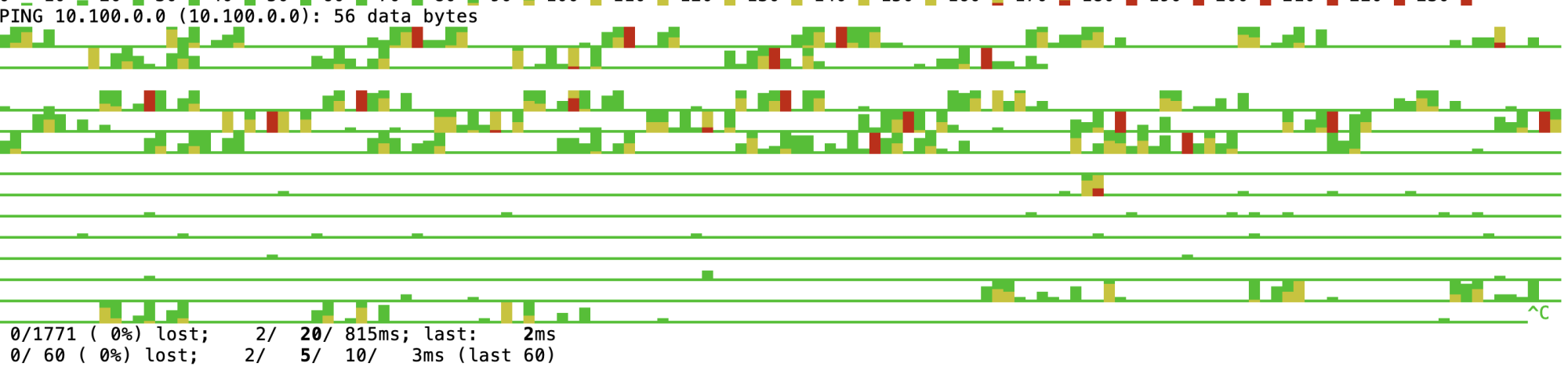

I've been running pretty ping to the local router (an Eero 6 Pro), my ISP public IP and Google DNS (8.8.8.8)
👆 that is my local router. Each character is 1 second. Thin line is normal (2ms) response to the router. and taller bars are more latency.

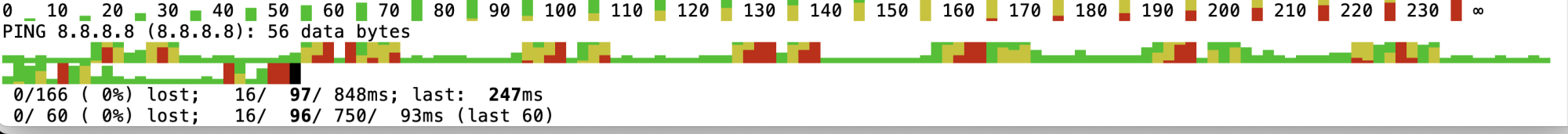

Here is Google (8.8.8.8)

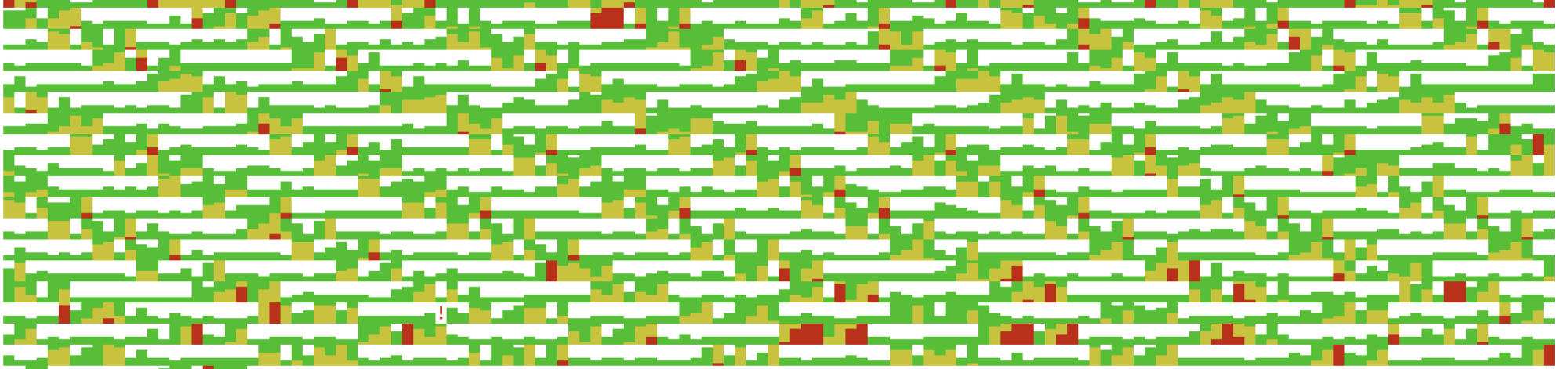

Here is a half hour
As you can see some cyclic or periodic process or activity is happening to cause slowdown in wifi for a few seconds before going back to normal.

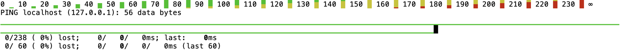

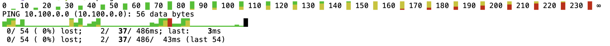

The goal would be to get close to this type of thing. 👆
I know this is localhost, but I've had wifi that was 2ms with very constant connection and not much jitter at all that looked like this before.
