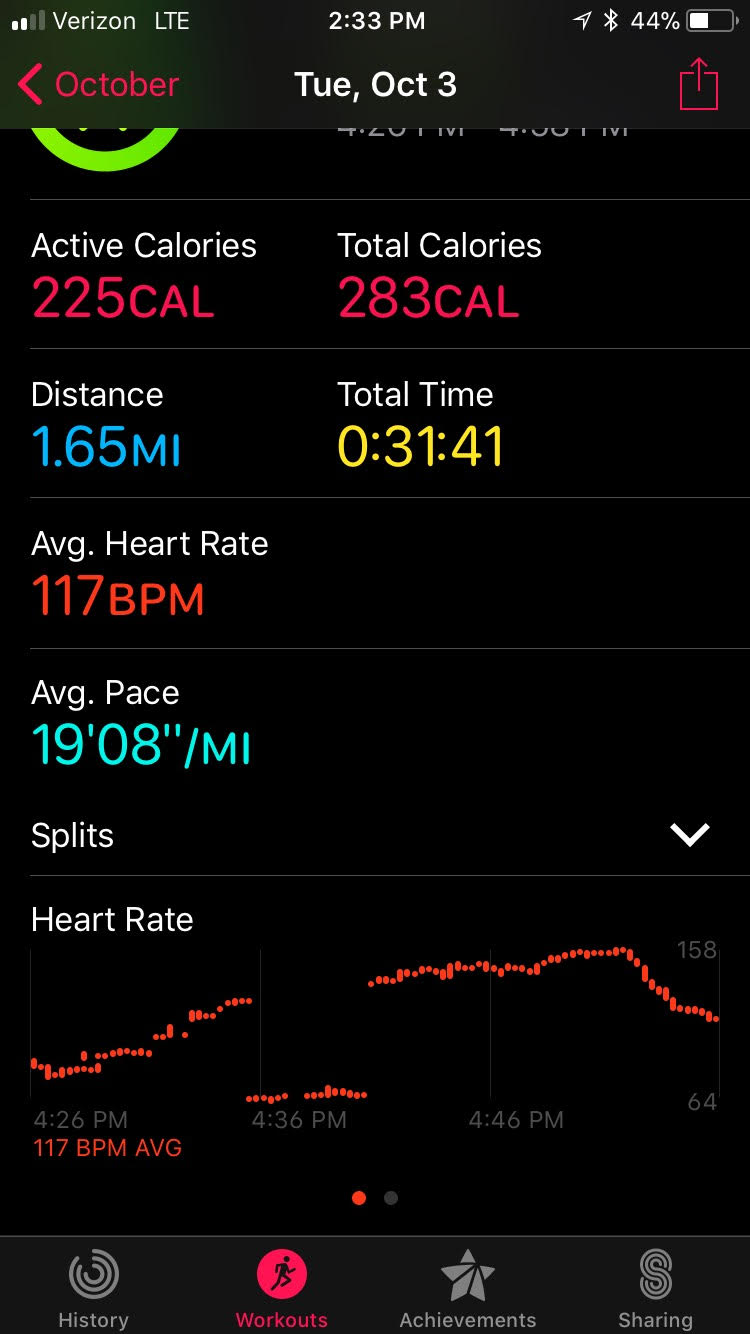

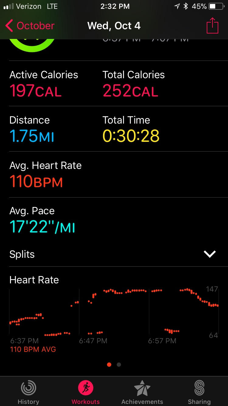

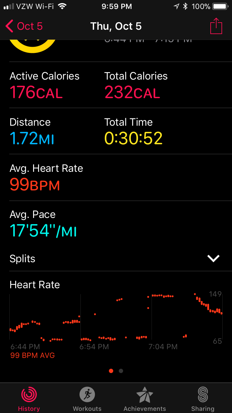

So I got myself a series 3 SS model and I've been trying out the workout function but seem to be getting strange heart rate monitoring results. During a workout I would look down at the watch and a couple times during the workout the heart rate monitor would be grayed out as if it completely lost detection of the HR. It would drop down to a resting ish heart rate of 64. Then it would eventually come back. I thought it might be because I swiped over to change to another song but that just doesn't feel right.
Has anyone else experienced something like this?

Clearly this isn't working haha.
This is just a "indoor walking" exercise so it really shouldn't be that hard for the watch to keep track of my heart rate. I did notice that it seemed to go dark when I swung my arms while walking. The watch is snug on a Milanese loop so it's not really moving. Perhaps I'll try wearing it further up on my arm rather than on my wrist to give it a flatter part of my arm to read.
