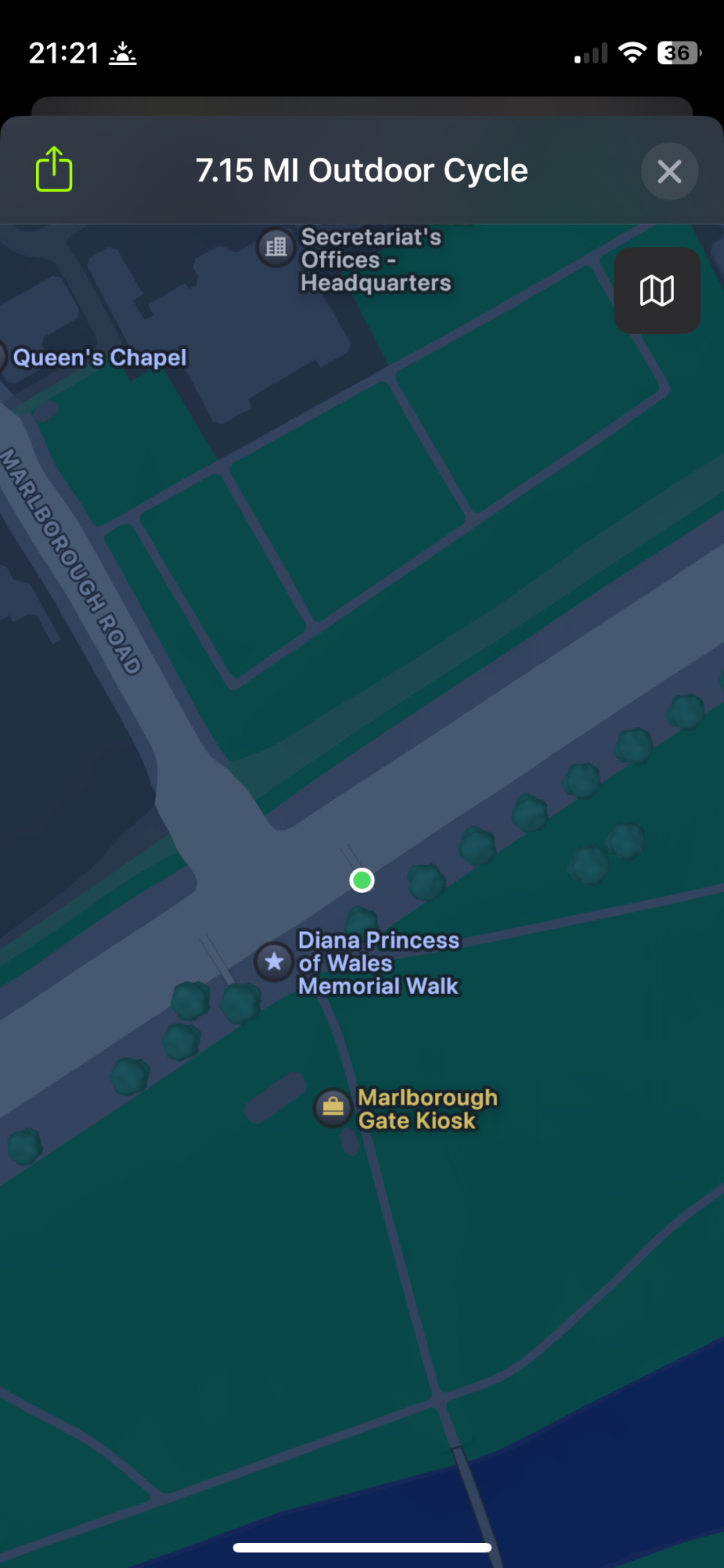

Really confused why I can no longer see my route for workouts. Wondering if anyone else is experiencing this. Used to work absolutely fine prior to WatchOS11.
This is the third or 4th time it’s happened. I just get this: IMG_6657.png
The stats are all there, but it’s like it hasn’t been tracking the route, yet it’s able to tell me (accurately) how far I’ve cycled. How can it tell me distance, without showing me that distance on a map?
