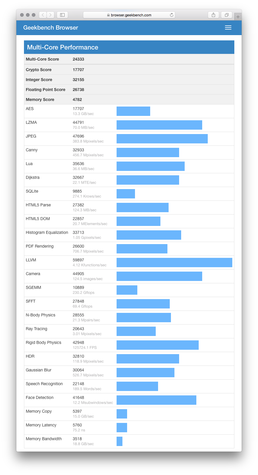

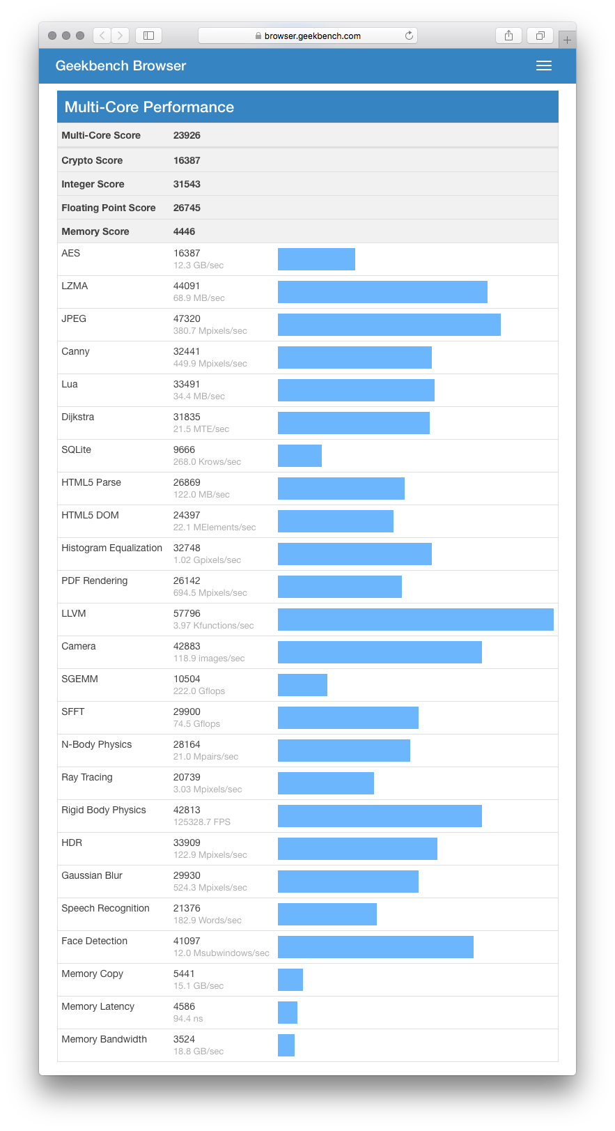

I did some extended testing to this particular topic, comparing 6 x 16GB 4R vs. 2R in a dual CPU 5,1.
Sent each configuration trough 10 runs of Geekbench 4.3.4. Here are the results for the memory performance:
4R
2R
As one can see, at least with this benchmark, the average overall memory performance tends to be even better with the 4R dimms. But, as one can also see, results are within a range so close, that most likely no "real world"-differences should be noticeable.
Here are two typical results.
First for the Quad Rank (4R)...
...then for the Dual Rank (2R).
As shown, not even the bandwidth, which at least should be higher for the higher frequency, shows any "real" difference.
So the "disadvantage" of using 4R vs.2R memory with the 5,1 seems to be much more of a theoretical/cosmetic issue than a real one. The effect of using 4/8 vs. 3/6 modules of the same size will always be much more significant and worse.
