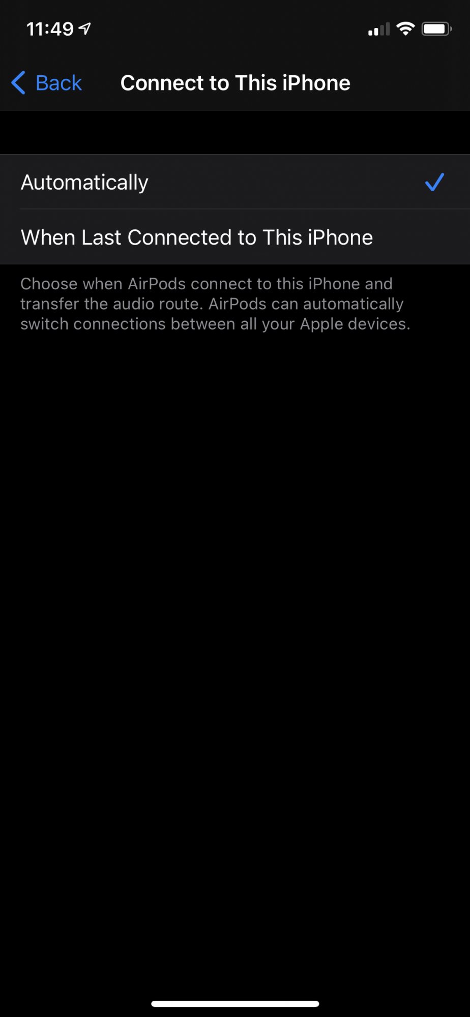

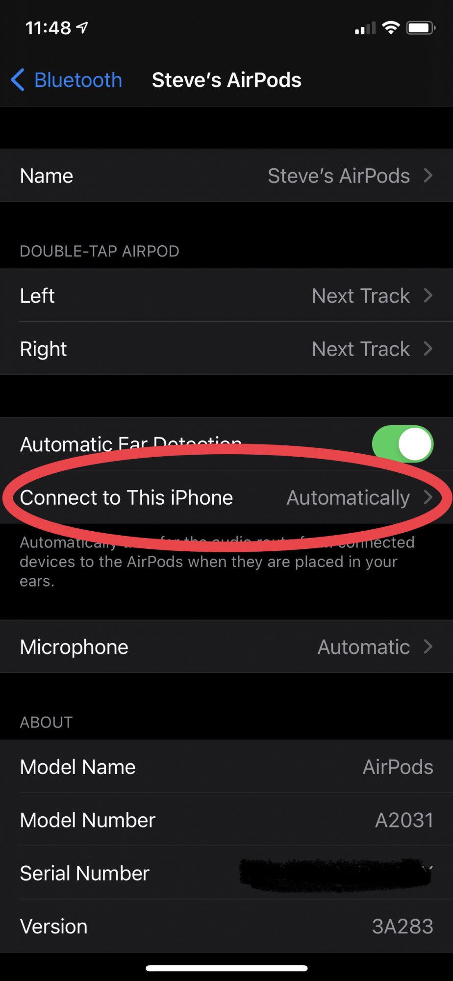

@PinkyMacGodess Regarding Blue Tooth headphones, are you having issues with the auto-switching between devices? If so, I think you can stop this by going into Settings/BlueTooth/hit the ' i ' button/ change the settings in 'Connect to this iPhone' section. This screen...
Not 100% this will work for you, but might be worth a go.
View attachment 1696054 View attachment 1696056

  • Bluetooth auto-switching is a PITA. It's gotten better, somewhat. After all of the updates, if there was a beep on the MBP, I'd lose my music. Sometimes it went back, but often the player was paused. I have a fight now at the beginning of a ride over who keeps them. Everything tries to grab them, but yesterday, everything worked well, until 62 minutes into the ride like I said in my post. Weird...
Yeah, it's not perfect, but it seems to be veering farther from perfect at times. Having Bluetooth just totally drop was a surprise. I could see that with ANT+, but Bluetooth had been pretty solid, with just occasional trainer telemetry dropouts lasting fractions of a second, until lately. I was hoping things would get better, not worse.
