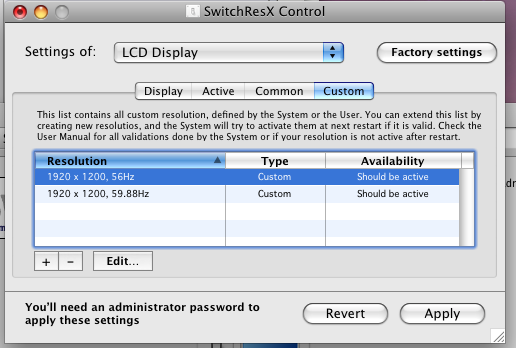

Same Problem as Mediapirate - Working Now
Hi Mediapirate, I had the exact same problem as you had. PRAM Reset, reinstalling Leopard did not work. I installed Switch ResX while connected to external monitor and made a custom resolution with the following settings under horizontal:
Front Porch - 126
Sync Width - 206
Back Porch - 332
Under Vertical I only changed:
Scan Rate to 56
When you launch SwitchResX choose the custom tab, then choose the correct LCD under Change Settings of: For me it was LCD Display (2). The choices here will be this and the external display (DELL 24... for me).
Then hit the plus sign to add a new custom resolution. Use the settings I mentioned above.
I attached some screenshots of SwitchResX.
I saved this custom resolution, restarted the computer and it started working. For some reason, this just activates the monitor to work and it seems that switch Resx is not required after it started working.
I am going to try to uninstall switchresx and let you know if it is still working.
The LNT154U2-L04 monitor is much better than the LNT154U1-L03. I used to have a buzzing sound from the inverter which is now gone. I am really happy with this new screen.

Some More Steps
I lost the screen but I got it back.
When you use Switchresx to create a custom resolution and you go to the default apple display system preferences you will see the refresh rate should be at 56.
What you need to do is set up the new custom resolution as mentioned before. Now what you need to do is have the external screen connected to the macbook pro. Go to system preferences and click on displays. While connected to the external screen, the external screen display options comes up on the window on top. Behind this window is the display preferences of the internal monitor. Here change the resolution to 1920 x 1200 and change the refresh rate to 56.0 Hertz. Restart the computer and disconnect the external monitor before the gray screen.
This might help and good luck getting it to work.

Okay, I lost the screen again with the SwitchResX method and swithresx really does have problems working in Leopard. It keeps crashing and for me it stopped working. So I tried the above fix. The file to download is screen_fix.zip on page 22 of this thread. I did the above steps without having the external monitor plugged in on restart. The screen just came up with no problems. I hope I do not lose the screen again.
Also, I installed Vista through bootcamp - funky colors. I will do the powerstrip method to fix it.
