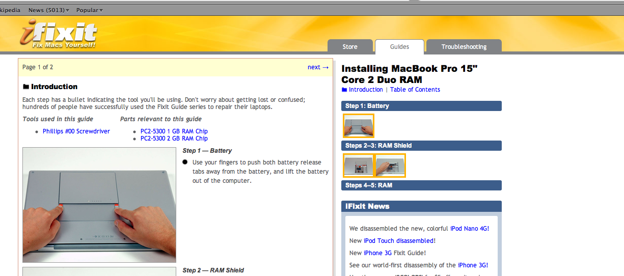

  12. Neil321 macrumors 68040
    Neil321
    Joined:
    Nov 6, 2007
    Location:
    Britain, Avatar Created By Bartelby
    #12
    Well i suggest you get in touch with the people who make the guides,but hey maybe they don't know any different
    click for larger

  16. Weaselboy Moderator
    Weaselboy
    Staff Member
    Joined:
    Jan 23, 2005
    Location:
    California
    #16
    The ten screws holding the back cover on a MBP are #00 Phillips. The iFixit and OWC install guides and my personal experience confirm this.
