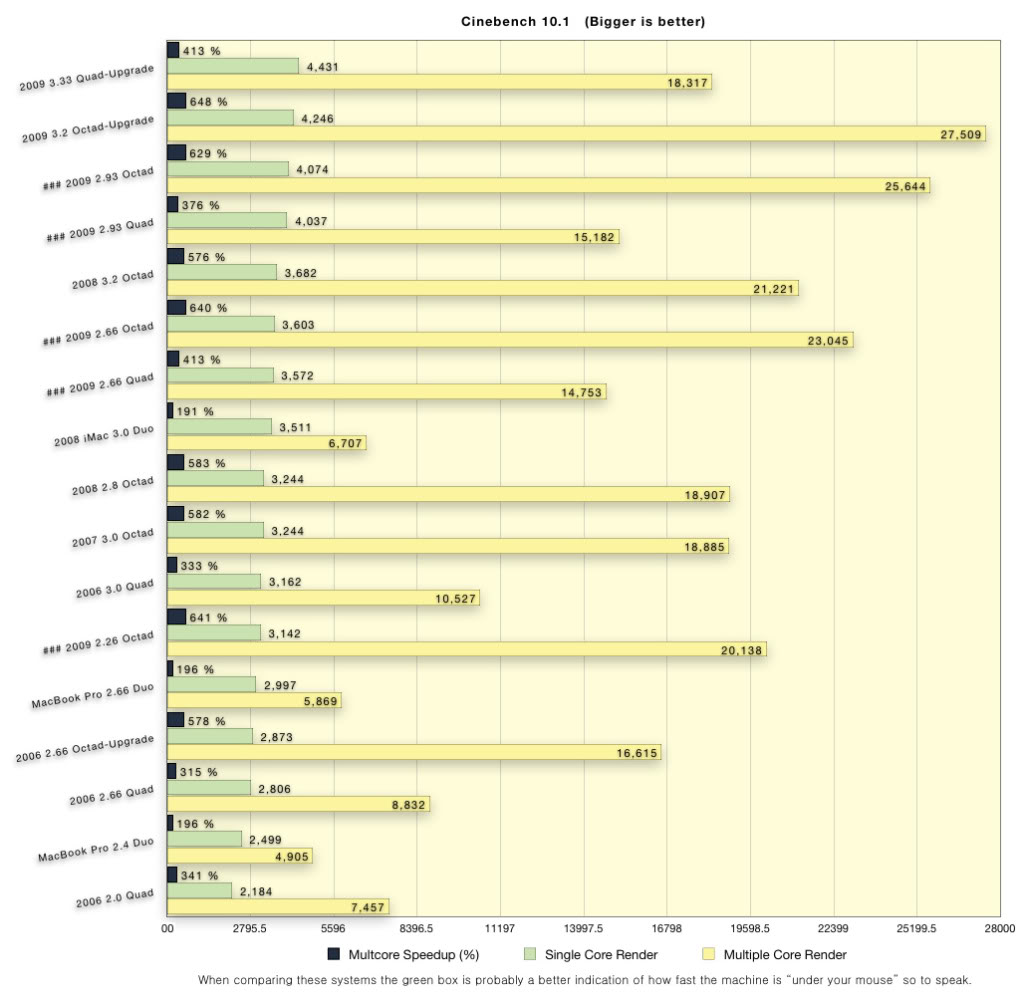

Between the two systems, I'd go with the '08 3.2GHz refurbished unit.
It's faster than the base '09 Octad, and easier to use the HDD bays with an internal RAID card, if you ever choose to do so. It's an EFI64 based system, so you're OK there (a few niggles with the ODD_SATA ports, as you can't run Windows drives from them, or boot a Windows install disk, but minor overall).
the 08 is faster than the base 09 octad even with the large memory bandwith increase from the nehalems ?
the only thing that scares me about not getting the newest one is fear it will be outdated very fast .. with a pc .. i can just swap certain components then im up to date .. this is the first time ill be buying a complete tower that i cannot swap out so that is why im having such a hard time deciding
Yes, as FCP can't use the additional memory bandwidth. There is extremely little that can, and what there is, is primarily for servers. Workstation use that can, would be things like simulations (weather, plate techtonics,...).
Take a look at the Cinebench Chart below. 😉
Understandable, but what you need is EFI64, which the '08 systems have. This will allow you to continue to be able to upgrade the graphics cards (and other 64 bit PCIe hardware that uses a Boot ROM), and allow you to continue to upgrade the OS after it goes K64 exclusively.
Any issues beyond that, will be intentional by Apple (i.e. change the firmware to another standard to forcibly break support for the existing systems, as they are in the process of doing with EFI32 based systems). The '09's also use EFI64, as will the 2010 models. They can stick with EFI64 for awhile at least. 😉 The question is, "Will they?".

Given the performance difference, the '08, even with the upgrades is a decent system, and not a bad deal. You'd have to upgrade the '09 anyway.
And the '08 can be done less expensively than you might think, particularly if you locate a PC version of a 4870 that can be flashed. It's in the details.
Work out the numbers for both, using 3rd party upgrades where ever possible (I'm not sure if 6GB will be enough RAM, and am presumming you'd need 12GB). Then see what you get.
If you'll never run a RAID card, then their both on equal ground. But if that's not the case (and RAID is usefull given the software you listed), the '08 really begins to shine. No adapter to use the internal HDD bays is required, and you don't loose the ability to use the SATA ports on the logic board (you do with the adapter need for the '09's, which is $165USD).
The '08's have an advantage with SSD's too, as the '09 systems SATA drives are limited to ~660MB/s total (throttled) for all 6 ports (ICH10R chip that attaches to the X58 chipset). It's a design limitation that might be important to you.
As I said, it's in the details, and I don't have enough information to give more specific advice/information. But hopefully, this is enough to steer you in the right direction. 🙂
