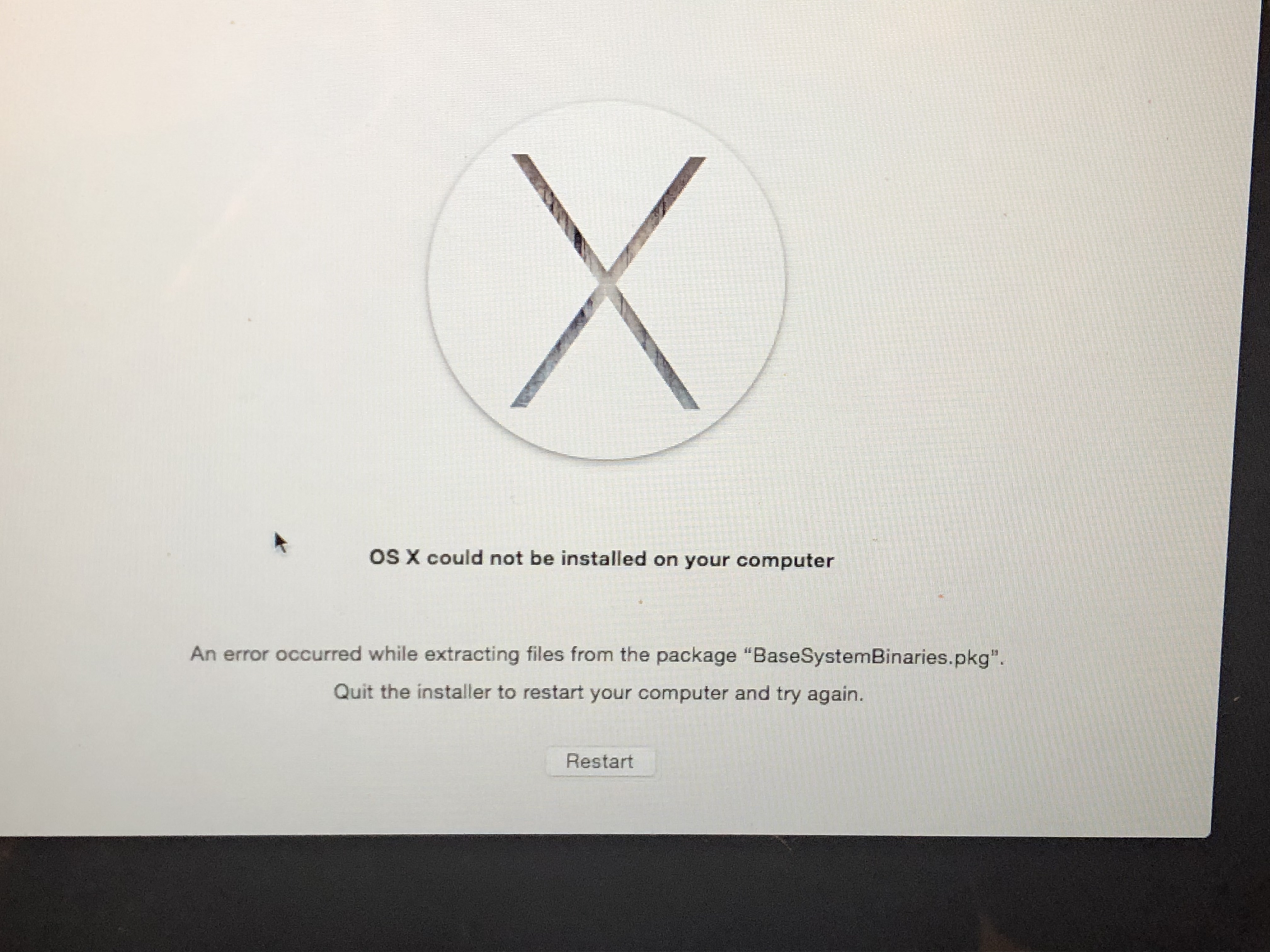

Hey guys,
I’m attempting to do a OS X internet recovery install in my 09 MacBook Pro. I have formatted the HD and the install will begin like normal and go through the first few hours of loading like everything is fine and then once the MacBook restarts and it attempts to finish the install I get this error shown below. I’ve tried swapping out the ram with no luck. Any ideas?

You can't DO "internet recovery" on a 2009 MacBook Pro.
That feature wasn't implemented until the 2010 models, if I recall.
You need to create a USB flashdrive installer on a DIFFERENT "working Mac", and try the install that way.
What version of the OS are you trying to install?
In the disk utility it gives the option to do an internet recovery...not sure why it would be there if it wasn’t possible. It’s a mid 2009 I believe.
And I’m just trying to install OS X because that’s what came on it
I'm not sure what you are seeing in Disk Utility.
There is no option for internet recovery in Disk Utility, so you may be misinterpreting what you see.
Internet Recovery system is not available at all from any 2009 Mac. It was not added until 2011, and provided through a firmware update to 2010 Macs, nothing older.
Best way to proceed would be to boot to an OS X installer, and erase the internal hard drive completely - If you are booted to the Recovery system, that's a partition on the same hard drive that you want to install OS X, and may be the reason you are failing.
You will need to make a bootable OS X installer on a different Mac. Looks like you are trying to install Yosemite on your MBPro, and that would be a good system for now.
