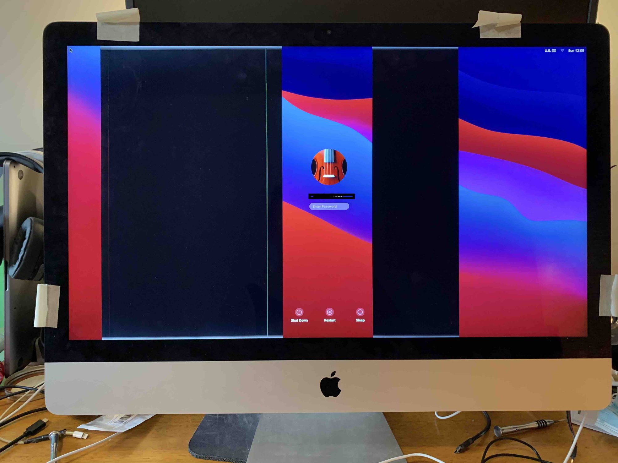

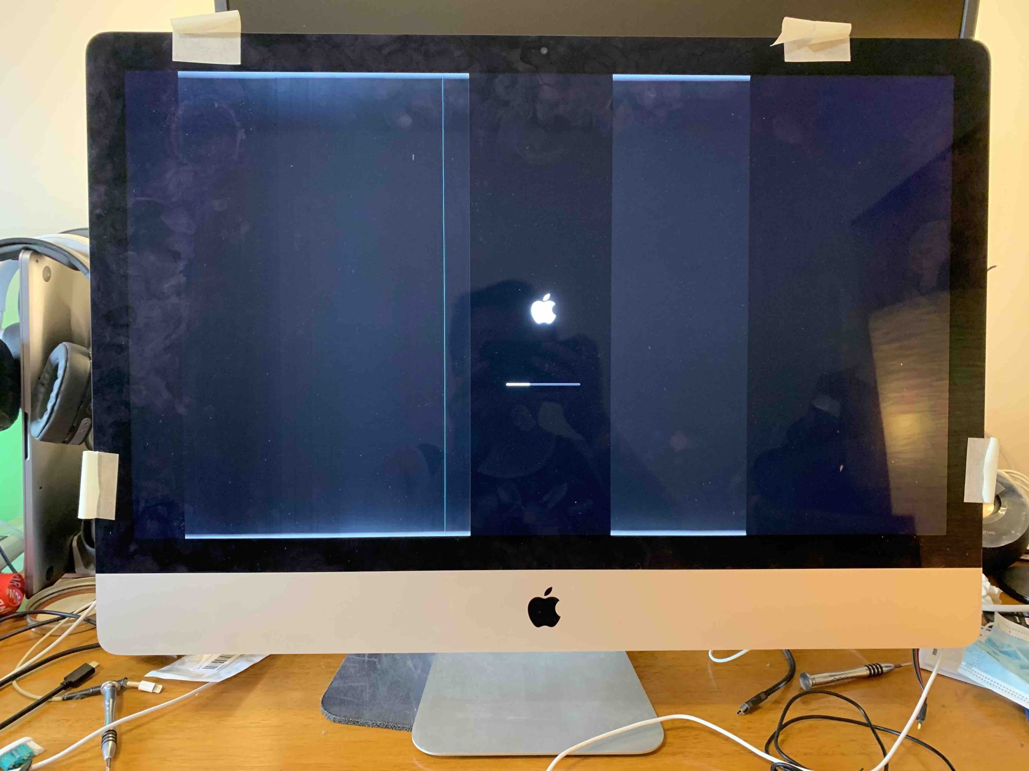

just found out that my 27in imac display got damaged during the the process of taking it off and upgrading SSD in which the display developed a blank column.
oh boy I didn't know how easy to damage by not using the correct tools ummm..feel so bad, btw did you find a way to fixed yours without replace a new one?
