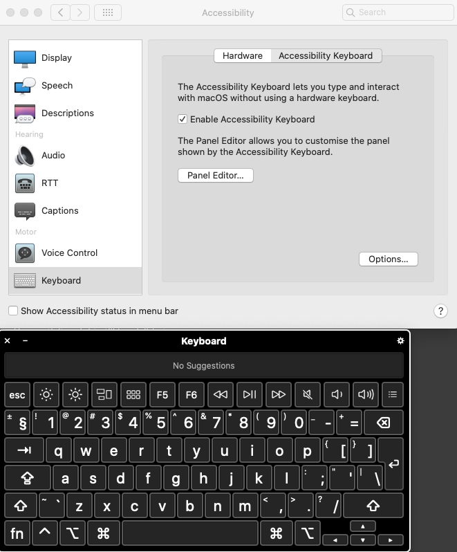

#2
  1. Open and enable Accessibility > Keyboard > Accessibility keyboard
  2. Select any input area as Browser Address bar or Form
  3. Click whole 1-9 Number part through Accessibility keyboard + your Mouse/TouchPad (Do not use keyboard) and also write into the bar/form all the "special characters" as @#$...
  4. Then try Keyboard keys
  5. Disable and Close the Accessibility keyboard
  6. 🎉
