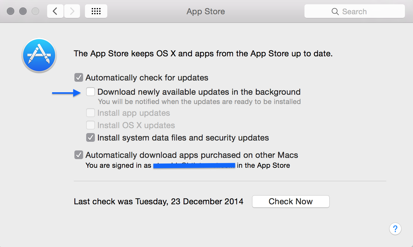

I don't believe it was "forced" on anyone, I had to download it manually during a visit to the app store, even with my settings as shown in the attached screen shot.
It's automatically installed if you have the option enabled as already said, but if you have the auto-install option unchecked, it's a manual download and install.

Was it the NTP security update? Check the app store again. As far as installing automatically, do you have the install security update option ticked in app store preferences?
Thats it.... option was ticked for security updates.... i could have sworn i had nothing checked. I prefer to know what is installed/updated. But it does not show up under recently installed updates, did not know that that would be the case either.
