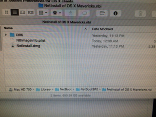

Now I downloaded Mavericks Server.app and created Mavericks installer, then copied it to the Yosemite Server.
I see the Mavericks installer as an option, and even if I set it as Default...
The netboot will pick Yosemite...

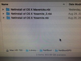

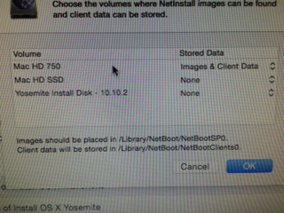

You copied a .NBI folder? What path on the Yosemite Server did you copy it to?

Try moving all other images out of of the folder and seeing if it will work. I can't help you anymore, sorry.
I was able to netboot and at the installation screen (where I choose disk util, install os x, etc) choose start up disk. I chose the netinstall of Mavericks and installed that way.
