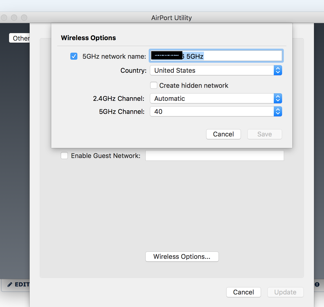

View attachment 584941 no issues for me.
I've got the 2.4 and 5GHz networks separated in 5 locations with different names - no problems with 4 Macs running 10.11.1 or 21 Macs running 10.10.5. All stay locked onto the 5GHz networks.

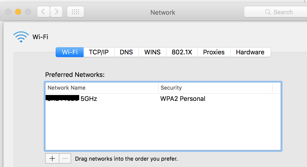

In system preference > Network > Advanced > I say both my 5 Ghz and 2.4 Ghz listed, then I just highlighted the 2.4 Ghz and removed it. Unknown if you have same.

If the 2.4Ghz and 5Ghz network have the same name (SSID), then Mac OS will decide which to connect to based on which has the best reception. 2.4Ghz can actually penetrate through walls better than 5Ghz, so it's actual range is sometimes better.
If you insist on staying on the 5Ghz network, give it a different name and select to connect to that network.
