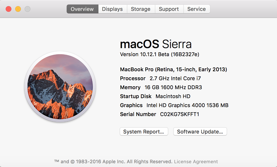

So I tried installing the new developer beta just now and during the install process the progress bar would not load. I stupidly decided to hard reset the machine. It booted up normally and now shows that I'm on the current beta, but I feel that it didn't install the update fully.
Tried looking for the update again in the app store, but it now shows that it was fully installed =/ Not sure what I should do
Check the build number. 10.12.1 beta 1 should have build number 16B2327e.

It does show that build number. I was just worried, because I restarted when it was installing about 10 mins into the process. When it booted up it was displaying that I had the current version.
The download process went fine enough from the store, I was just concerned that I turned it off too quickly =/

I don't believe I had the utility installed before I updated and found it in the app store. Would this not allow me to install new updates?

Usually by that point things are installed and OS X is just doing clean up/repair at that point.
