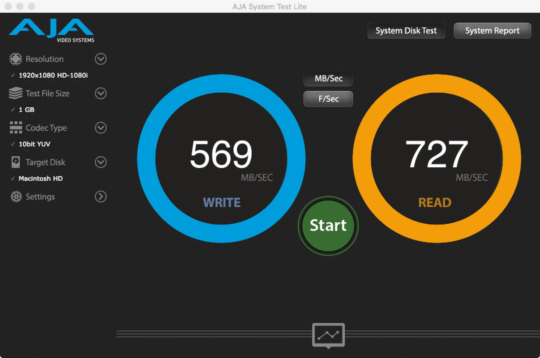

13" Retina Macbook Pro Late 2013, High Sierra 10.13.2

And I still can't get it. How can a VM not able to work if the SSD sequential speed changed?
