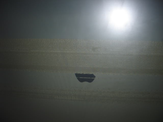

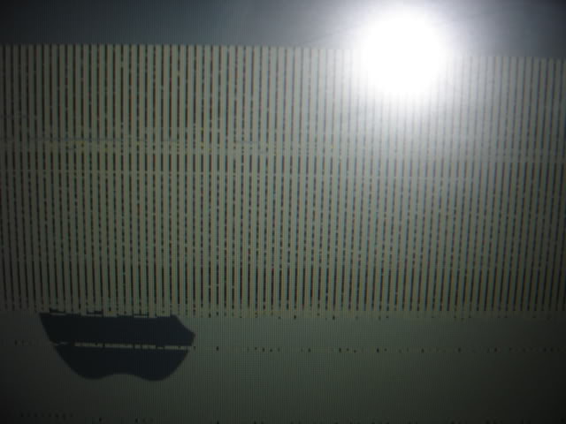

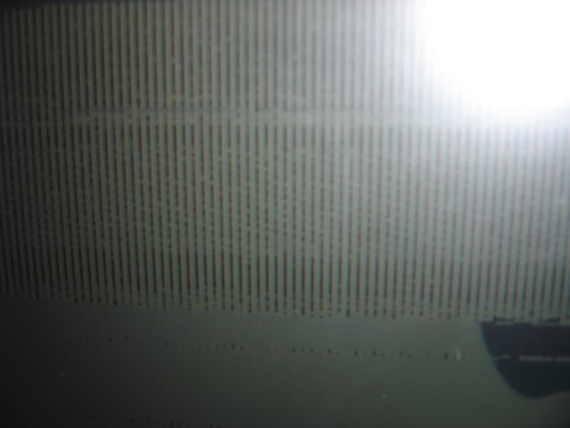

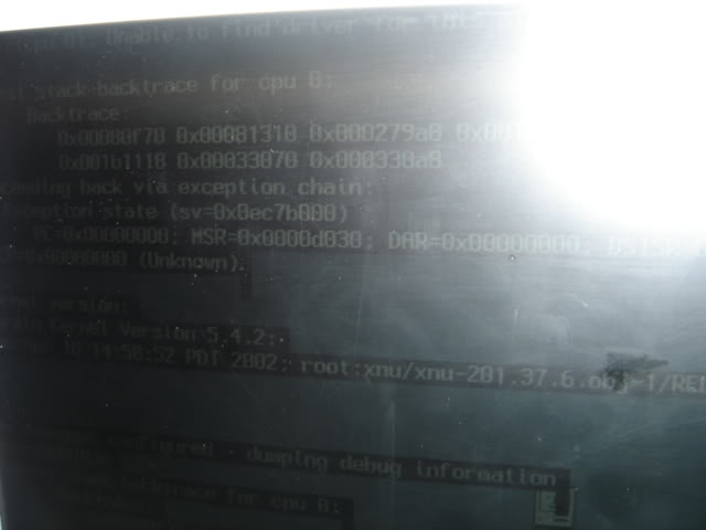

So I try to put the install disc in and boot up the iBook Clamshell and I hold the boot key down It loads into 10.2 gray apple screen but then I wait a while and it shows this:
PLEASE HELP!

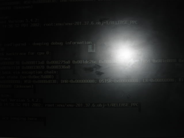

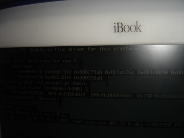

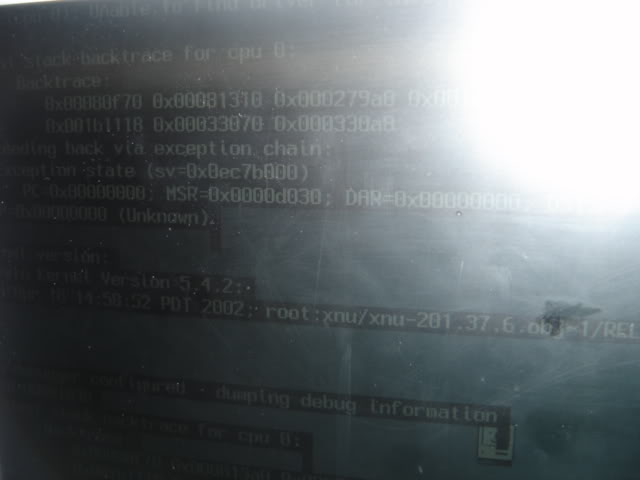

Just tried resetting the PRAM and it didn't work. but instead I didn't hold down option and got this.
It said Unable to find drivers for this platform: Powerbook 2.2
These disks your trying to boot with, are these the original ones that came with the ibook? The recovery media are model specific
No there burned from Nero on my pc. But they were working fine with 64MB of ram but it's way too slow to boot doing that.
That is more then likely the problem. You should be able to find clamshell recover discs on ebay for durt cheap. Like $5. Or else you can get a full install which will also be really inexpensive for 10.2 discs.
Also check the RAM requirements. I don't know if the clamshells can handle 256mb. Could be wrong, it has been forever since I had a clamshell in my possession.
