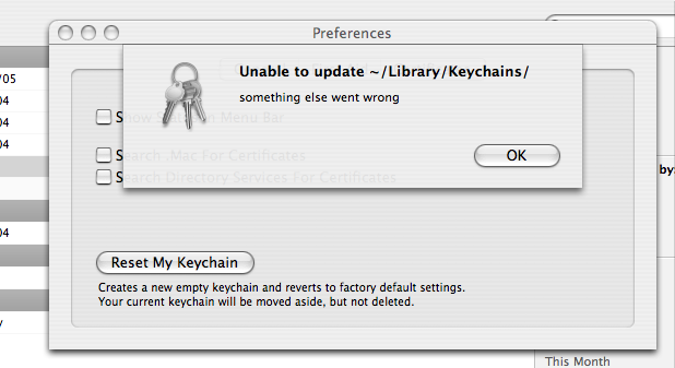

I have tried the suggestion found here and on other forums (i.e. create a new login keychain) but keychain access will stop in the middle of the process.

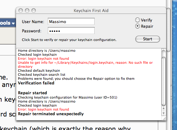

I have tried using keychain first aid (reset keychain) but the process quits (see weird screenshot attached).
I find that under library/keychains I do have a system keychain but miss the login keychain (which is exactly the reason why keychain first aid fails to verify).

This is what happens when I try to repair the keychain (see screenshot attached)
...but the file (/Users/yourlogin/Library/Keychains/login.keychain not in /Library/Keychans/) is really there, when you look in Finder...?
Nope, it's not there at all!
The only files in that folder are system.keychain and Microsoft_Intermediate_Certificates...
Is it really bad? Do I need to reinstall? 😕

Nope, system.keychain and the unmentionable file are in /users/username/library/keychains... and I am just not able to create a new login keychain (or any other keychain for that matter) as I get the "something else went wrong" error that you can see in the first screenshot I attached.
Actually, I just can't do anything in keychain... for example, when I open the app I get an empty keychain which is called "unknown" and is locked. Any options to act on the keychain (unlock, add, etc.) are greyed out.
That leads to believe the application is really screwed... 😱
