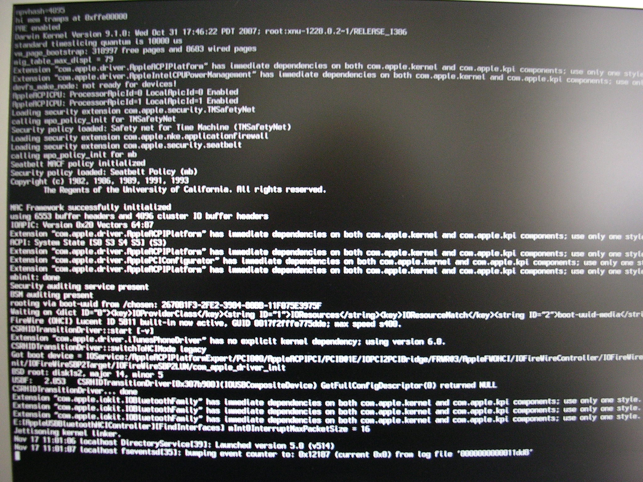

I have leopard installed on an external firewire hard drive with my MacBook Pro. After installing the 10.5.1 update, the system will no longer boot. It hangs on the grey apple screen with the spinning wheel forever. I've tried reinstalling leopard and updating again, same result. Thoughts?

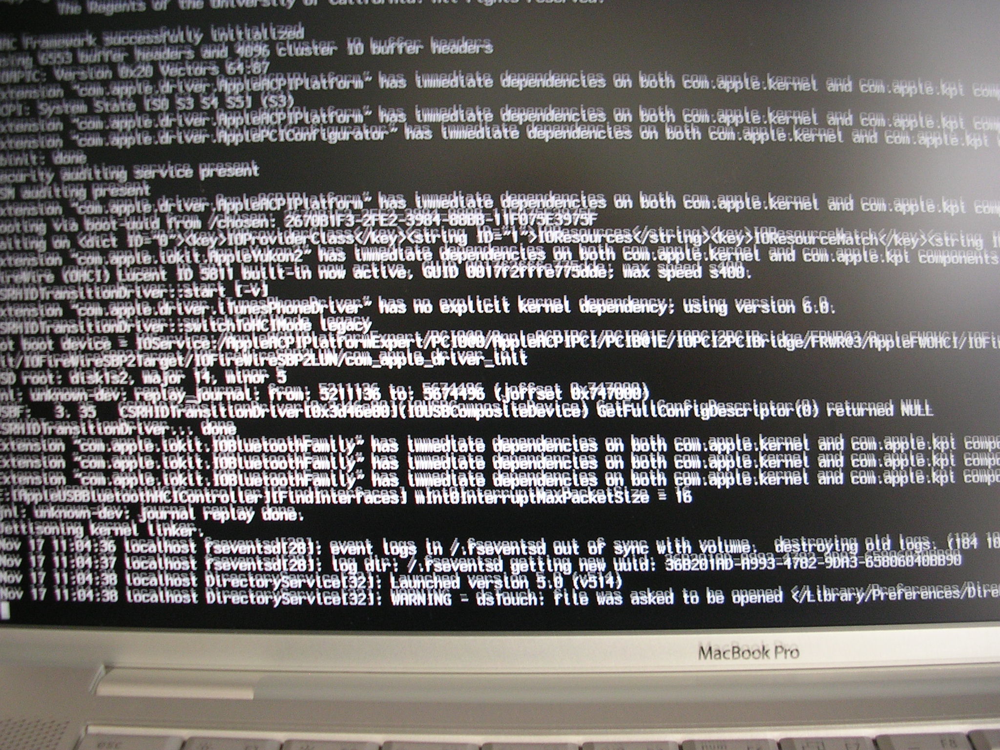

Try booting into Verbose mode (command v) at startup to give more details where it's hanging. Post here what happens or what it says...
This is what it says when I boot in verbose mode
Sorry for the fuzziness.

Several posters at the Apple Discussions forum are reporting the exact same issue, present with both USB and firewire drives. At least one person has reported success with transplanting their mechanism into a firewire 800 enclosure.

Managed to find a solution to this problem by deleting the following file:
/Library/Preferences/DirectoryService/.DSIsRunning
It now boots 10.5.1 with no issues.
