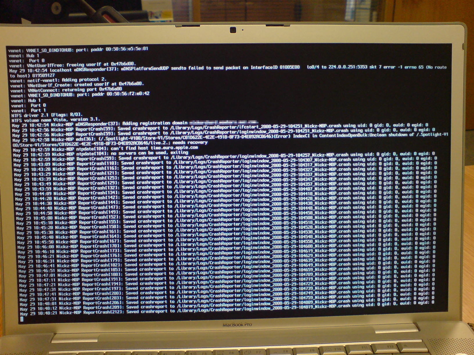

My Mac won't boot after the 420MB update sad.gif Just sits at the gray Apple boot screen with the spinning progress bar thingy. Left it for four hours last night doing that. I can hear my hard drive doing all sorts of things but it just wont boot. sad.gif
OK an update. I've booted into Single-User mode and run FSCK from the command line. It found some errors and successfully repaired them. However, my Mac still won't boot. It seems to be stuck continually writing crash logs to disk. I took a photo, hopefully its clear enough for you to see.

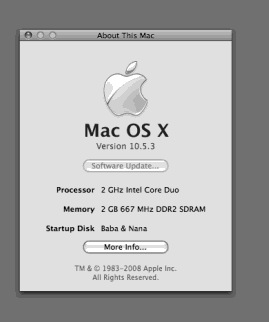

Mine acted funny also, and the MacBook seems to be fine, but Software Update on the iMac doesn't work and the SU button is grayed out on the ATM window.
exact same problem with mine, will not run software update. Currently awaiting a call back from apple. Software update runs on another user, but not me!
also the repair disc application in disc utilities is screwed.....

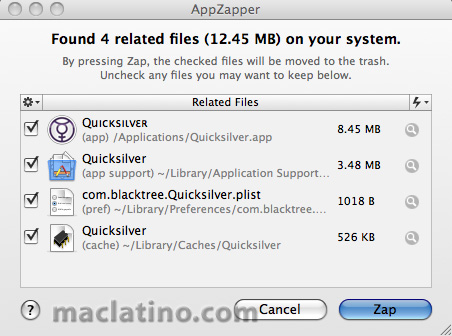

OK, so I don't even know what Quicksilver is lol, but I found this instructions in Spanish (http://www.maclatino.com/como-arreglar-quicksilver-en-mac-os-x-1053/#more-2119) and I'll try to translate them for you...
Ohhh forgot to say, these are instructions on how to make it work again... I don't know if they will solve your heating issues, but it's worth the shot...
If we only delete the application and install it again, there's no change and it remains not working. That is why we have to erase the Quicksilver associated files.
We can do this manually, or with third-party applications, we can use one of those explained on Screencast 005 (AppTrap, AppCleaner, AppZapper).
For those who want to do it manually, the files that need to be deleted and their paths are the following (see attached image).
After deleting them, we download and install Quicksilver again and we can keep enjoying it.
Hope that helps!
