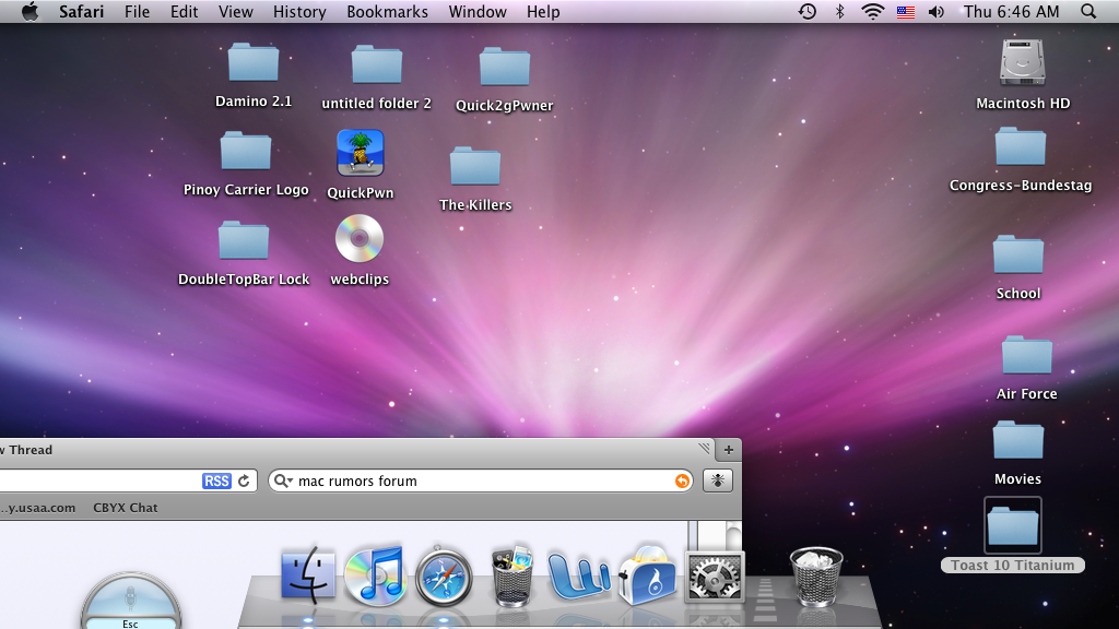

OKay so yesterday night I updated my Mac Mini. This morning I wake up to see my entire desktop, blasted to the front. It's like it's set to a much lower(higher?) showing a lot more grain, everything is pumped to the front, it's just bleck! I can't even see the top bar to help turn my computer off/on, restart...etc... I've already tried to change resolution, but to no avail. That background was even the one I had before the update.
Here's a screenshot so you mac experts can give me a solution
Thanks so much for all of your help!
Not seeing anything unusual here. If you're referring to the size of the icons, you can drop that down from the View->View Options menu item. Changing the icon size or grid spacing may resolve the issue you seem to think you have.
Everything looks fine to me. What screen resolution are you running on your monitor? (what's the native resolution) and does it match what the Mac is set to display? Other than that, everything looks normal in the screenshot to me.

On my end, before doing a screenshot, I can't see the upper bar (like file,edit,etc), and everything is MUCH closer, and grainy. It is saying that I'm running 720p, and Just EVERYTHING is close up. It's very painful to the eyes.
