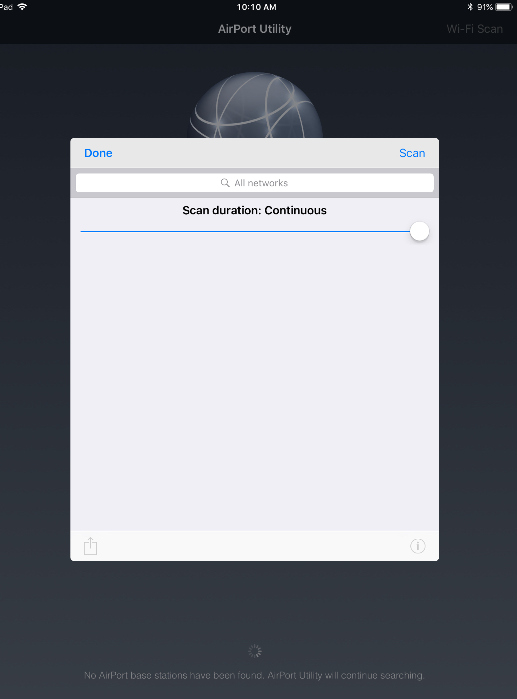

True on the Dr WiFi but I originally wanted the strength test.
Airport Utility works as I described.
I hit the "WiFi Scan" in upper right corner and the "Scan" in the pop-up window. It then shows visible networks and RSSI for each (e.g., my 2.4GHz signal shows -47dBm).
Errr... I see no such option in either the MacOS or iOS app. Is this a feature of the old MacOS app which is no longer readily available?
I have version 1.3.4 on my 10.5, downloaded early last year. Here is a screenshot before I hit "Scan":
Do you have an AirPort Extreme or Time Capsule? I have an Express as an access point off a Synology Router and this feature is not available.
I don’t have any Airport devices — I have an ASUS router. The utility also shows data for my neighbors’ visible signals and the signals from our xfinity modem’s own WiFi.

I have discovered this is a feature you have to specifically turn on in the settings for the Airport Utility app.
https://iphone-tricks.com/tutorial/6941-using-airport-as-wi-fi-scanner-on-iphone
ahh, didn't remember that. I do remember that finding an app with signal strength was difficult until someone pointed me to Airport Utility. And it turns out, I only bought one month of Dr WiFi premium (thankfully) so now it's just a variation of Speedtest and I'll delete it. I was also having problems with my home WiFi at the time and buying a new router ended up being the fix. I was able to dump my extenders and all is good now.
