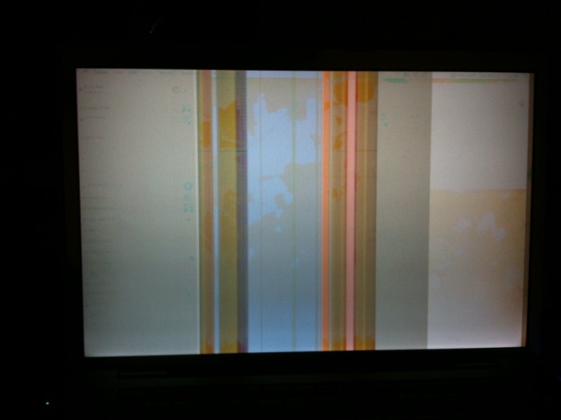

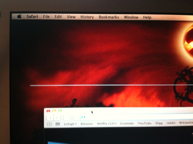

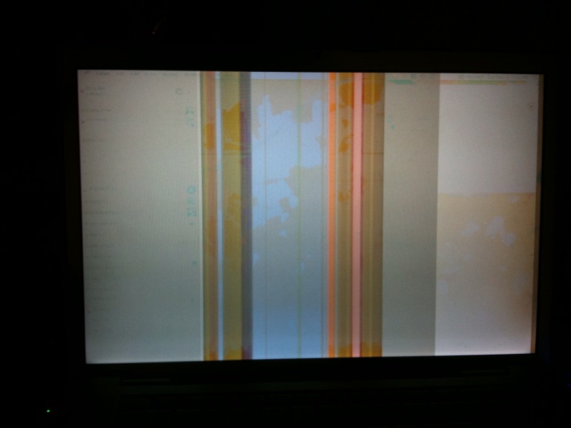

Over the past month I have encountered a number of bugs with Snow Leopard on my MacBook Pro (mid 2006). Ever once in a while, usually during high performance task (like watching flash or encoding with handbrake) the temperature of my cpu will spike to 85-90 degrees celsius and then the system freezes.
During this freeze, I can still move my mouse, but I am unable to click on anything on the dock or any program. Moving the mouse over the dock does not invoke the magnification either. I have to do a hard reset to fix the problem.

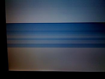

Also every once in a while, a long blue horizontal line will appear in on the screen. (sometimes their in iChat windows, sometimes safari, and sometimes the desktop as shown in the photo).
Does anyone know what is happening? Has anyone out their encountered this problem before?
I have been unable to use handbrake at all. I will start encoding, then CPU spikes and then the system "freezes" as explained above, forcing me to do a hard reset to fix the issue.

Sounds like a dying graphics card. Or maybe problems with your logic board, but mostly like the graphics card is choking.
I don't know if you have AppleCare (because it should be over soon since it's an '06 machine) but I would get it to Apple ASAP. Either way, I'd get it to an Apple Store or authorized Apple service center.

On another note, today my MacBook Pro froze during a Netflix Watch now movie and the screen went white with random white blotches, my 2nd monitor's screen went blank (I have my MBP hooked up to 24"Samsung Monitor), and everything locked up.
Is this still a graphics card issue? I read that it could be heat, but I have SMCfancontrol at 2700rpm.
Have you upgraded your ram by any chance. I had the same problems with the same mac only they occurred because of the new ram stick. Solution: I removed the ram stick. Dont know anything other than that, although I dough anything is dying. Do you have windows, can you test to see if the same happens in windows. If not, then its OSX. With mine, it never did that in windows only under OSX.
*Reseting the Pram/Nvram and the SMC helped a lot but only for 2 days when the problems came back.

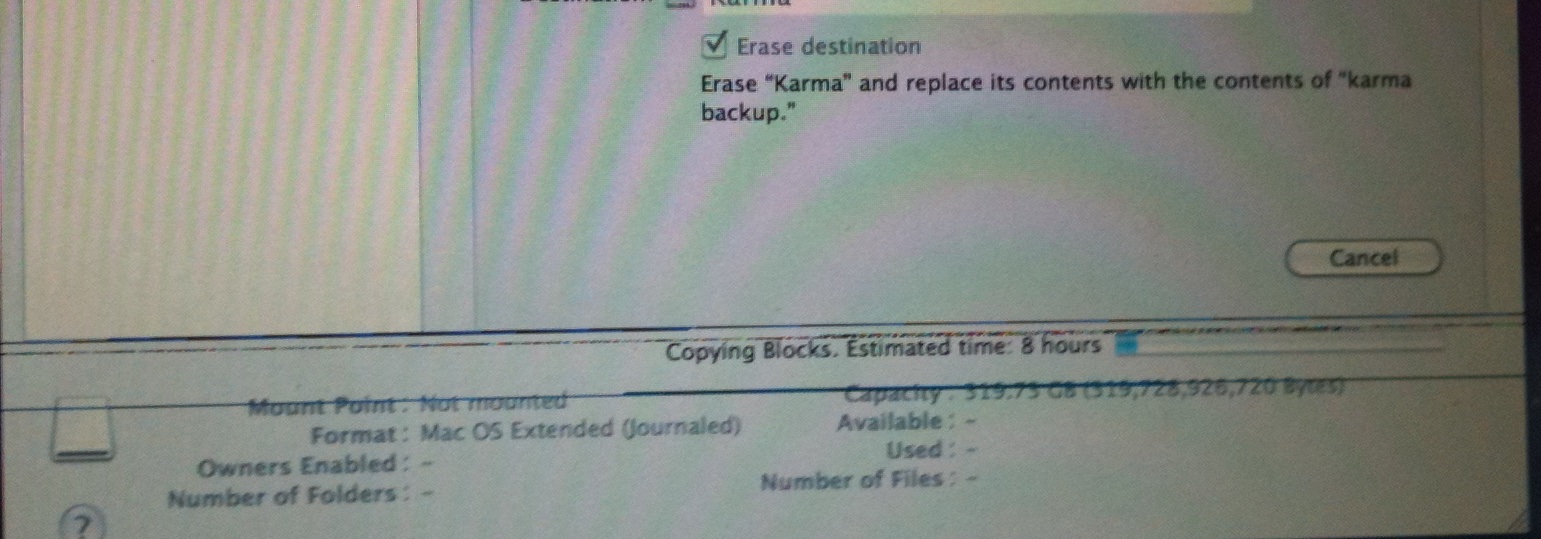

It happened again. This is what happened.
What do you guys think hardware or software?

I definitely think it's a hardware issue. But if you're able to, try a fresh install of OS X. I HIGHLY doubt it is software but there is a chance I could be off.

I know the GPU are soldered right to the motherboard. How much (since it is out of AppleCare) will this cost to fix? Or is it just better to get a new mac?
Based on the release notes of the latest Snow Leopard 10.6.2 build, I think this is a software issue. It describes my symptoms perfectly.

This looks like what happened to my mid 07 MBP running leopard. I ended with a new computer because they couldn't figure out what was wrong. I had the display changed twice and the logic board three times, nothing worked. the issues started with the right fan dying and than the graphics problems. I wasn't doing anything specific when it happened, sometimes it would show and startup and sometimes it would pop randomly. Sometimes shaking the screen lightly made it go away. My problem definitely wasn't software related.
here's a pic.
