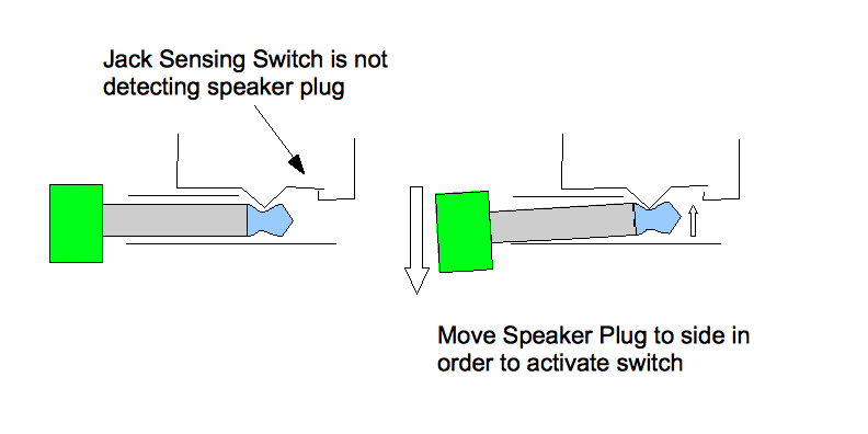

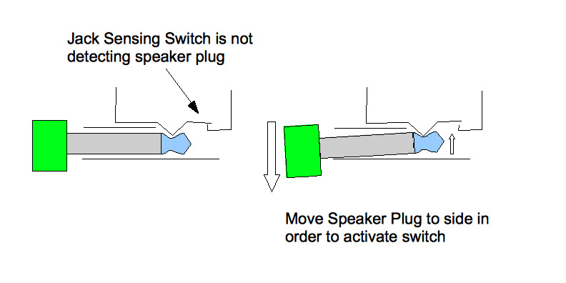

After updating to 10.6.2 the internal speaker got un-muted on my Mac Pro 1.1.
However, my particular machine does have a fussy rear audio jack sensing switch that makes having sound in Windows under Boot Camp kinda tricky.
In Mac OS, you can mute the internal speaker and the sound gets directed to the rear jack (even if no speaker plug is detected) and all is good.
In Windows (under Boot Camp) if no speaker plug is detected, you get no sound at all from the rear output regardless of what you do with the internal speaker.
In Windows, the only solution for my machine is to move the speaker plug to one side and that gets the speakers going. (see drawing)
I'm curious to see if anyone else has this particular issue.
