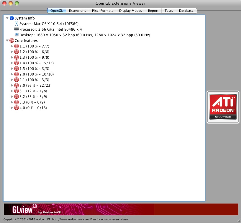

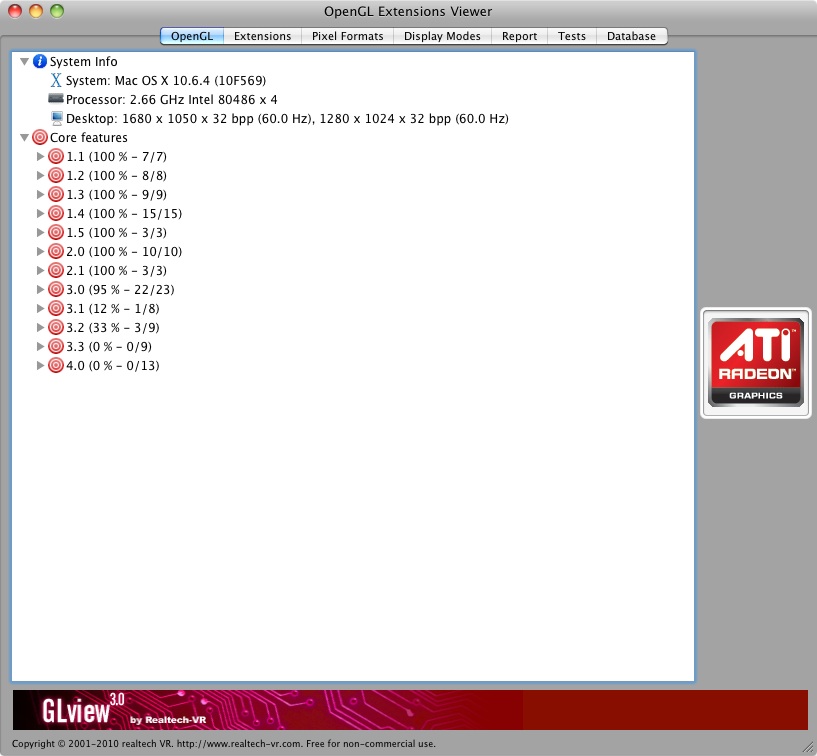

Results from Open Gl Test

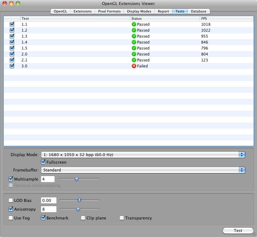

Hey Rominator. I did the test you had in the 4890 thread and here are the results. I had a XFX ZHFC as my standard card which seems to run fine after the update and the Sapphire card I mentioned in my first post as the non standard using the older drivers. I do not have a monitor as large as your so you may need to use a lower resolution. Also I had a second 17" monitor attached in both test. I did the test results without it for the XFX but results did not improve. Every test yielded the same results except for the ones that matters; the test.
XFX Results (Standard)
attachment.php
Sapphire Results (Non-Standard)
attachment.php
While it does not seem that the new drivers have significantly reduced performance they certainly have not improved things. It seems that one would be better off using the older ones at this time

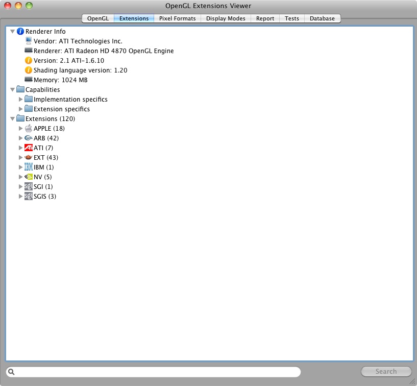

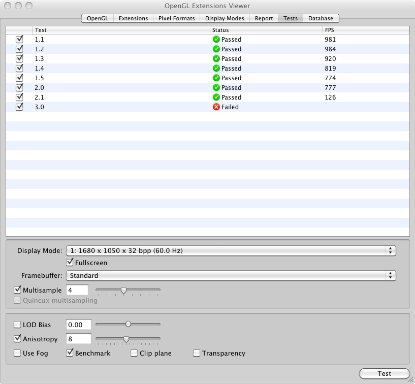

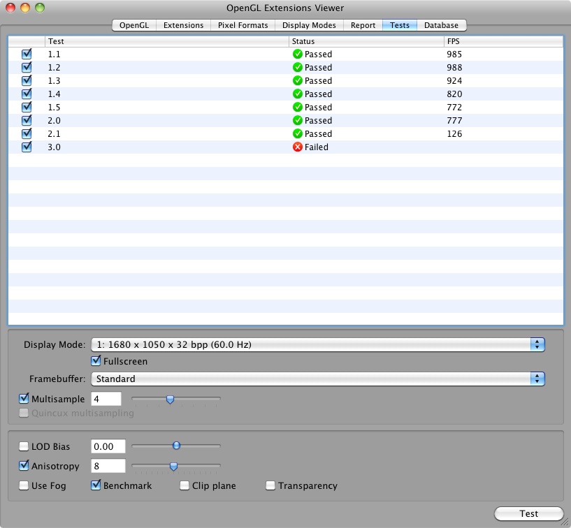

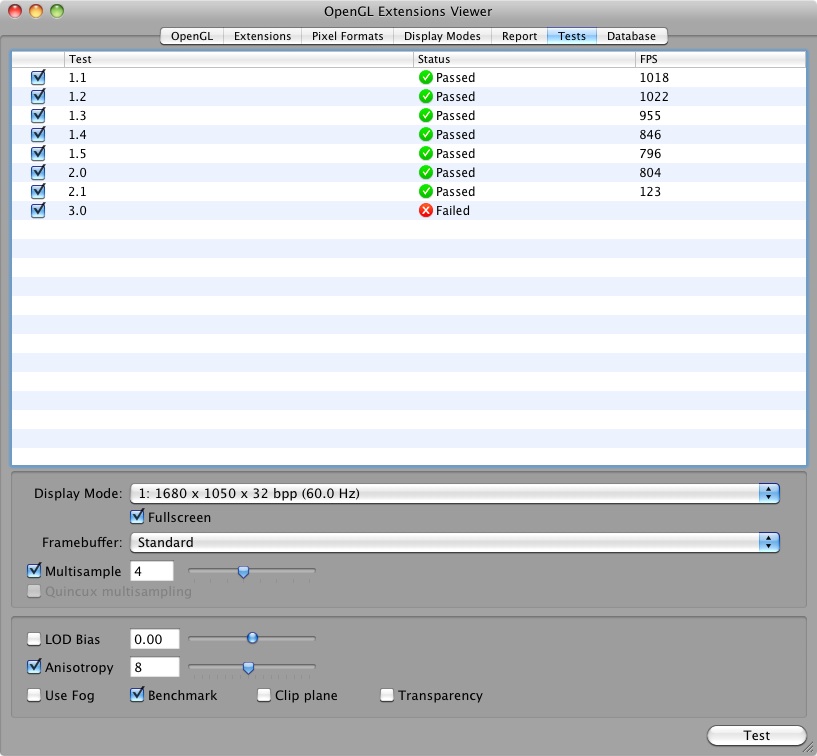

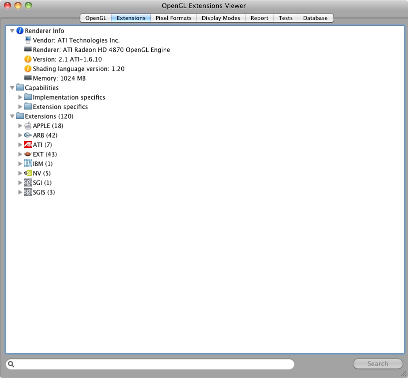

Hi again. I forgot to mention the difference in the extensions. The version number was different. 1.6.10 for the sapphire and 1.6.16 for the xfx. I also forgot that I had overclocked my sapphire cards so the results seemed to be skewed in the sapphires favor. So I did another test using the older drivers on the XFX. Here are the results
attachment.php
attachment.php
attachment.php
It seems that there have been no real improvements in term of open gl regardless of what apple has been doing to the drivers. Perhaps the changes in the driver are directed at improving compatibility and not necessarily performance.

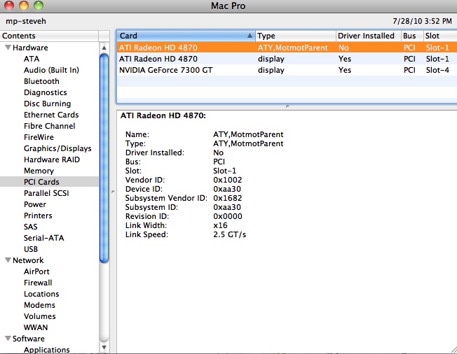

I see now that stable operation of my 4870 only occurs when I have my old GeForce 7300 installed (but not hooked up to a display) in a higher-numbered slot. After removing it, I retain stable operation of the 4870 for some hours or a day, but eventually it KPs again.
So something about initializing or driving the 7300 is also making things happy for the 4870; without the other card in the system my 4870 eventually gets lonely, sad and KPs on me.
Does this behavior ring a bell to anybody?
-Steve

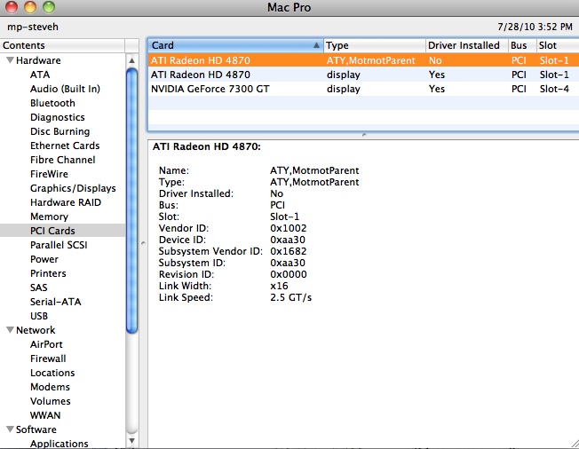

4870 Framebuffer driver
And is it normal that System Profiler shows that the framebuffer device associated with the 4870 has no driver installed? -Steve
