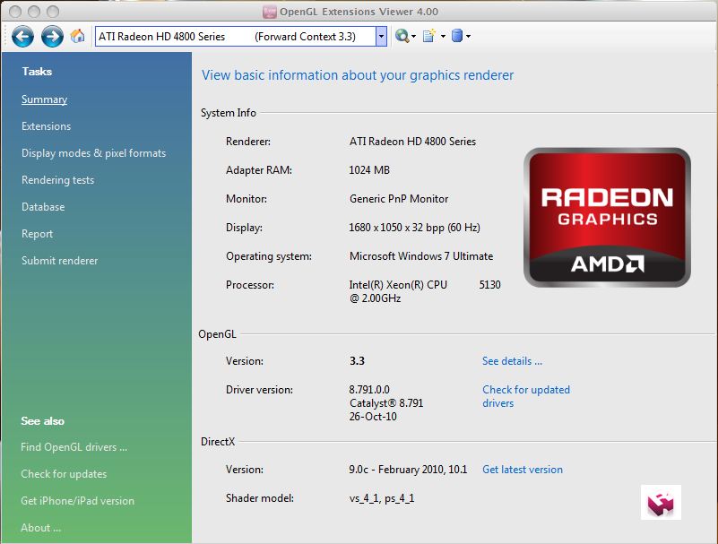

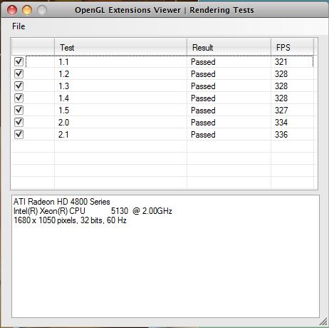

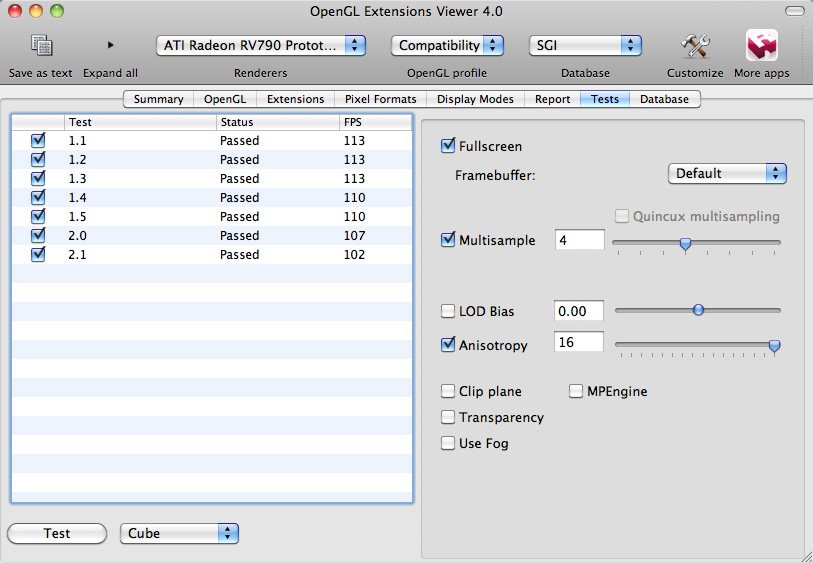

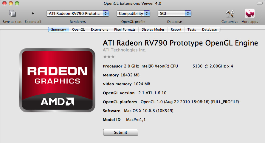

Thanks for the complete report on enabling the HD4890 under 10.6.8. If you have benchmarks for performance under GLView it would be interesting to see results. Just make sure you set up the test parameters as shown here:
attachment.php
No probs. Here are my results using GLView 4.0, which look similar to those above. I also thought i'd see how it compared to running it under my Windows 7 Bootcamp drive... the results speak for themselves.. think i'll be sticking with bootcamp for games for a while yet.
