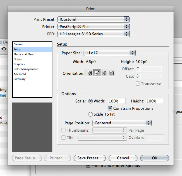

I'm in need of assistance. We have been using Leopard and CS4's InDesign to create some brochures. We upgraded to Snow Leopard and everything was fine but now when we needed some brochures printed. We went to InDesign, selected booklet print but the print to pdf option was gone.
Searching the internet I learned that it has been disabled in SL. A solution was to save to PF and use Distiller to convert to PDF... the problem is regardless of the settings the PF comes out portait (instead of landscape) and chops off our design.

Are you sure you have the settings correct in the print to postscript dialog? I've found it to be finicky in the past.
Sorry to repeat this, but are you sure you have it set up right, specifically the page setup dialog? I only ask because I just tried it and it worked fine. Indesign CS4 --> .ps --> Distiller --> PDF worked on my MBP running 10.6.2.
I recently reinstalled snow leopard and cs4 after experiencing stability problems after 10.6.2, so that test was done on an almost completely virgin system. If you've triple checked and you're sure the dialog is right, maybe it's a plugin or something that's interfering. Adobe software can be infuriating with small stuff like this... why can't a book be exported straight to PDF without having to "print" it anyway?
EDIT: FOUND THE BUG. I just tried printing it again, but this time with the ppd set to device independent. In that case I get the issue you were describing. I'm not sure what's going on, but perhaps the workaround is setting a printer and then a paper size?
