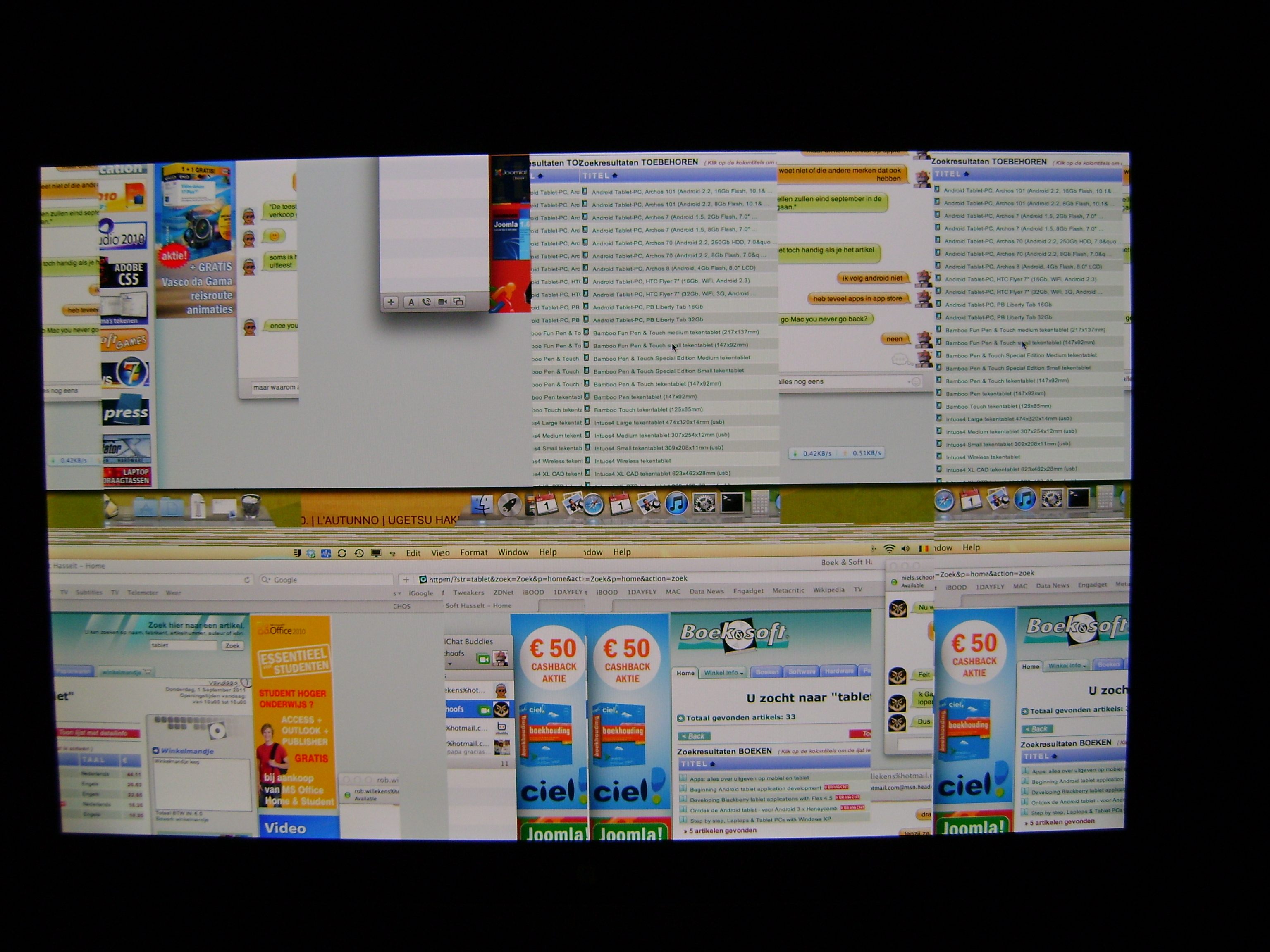

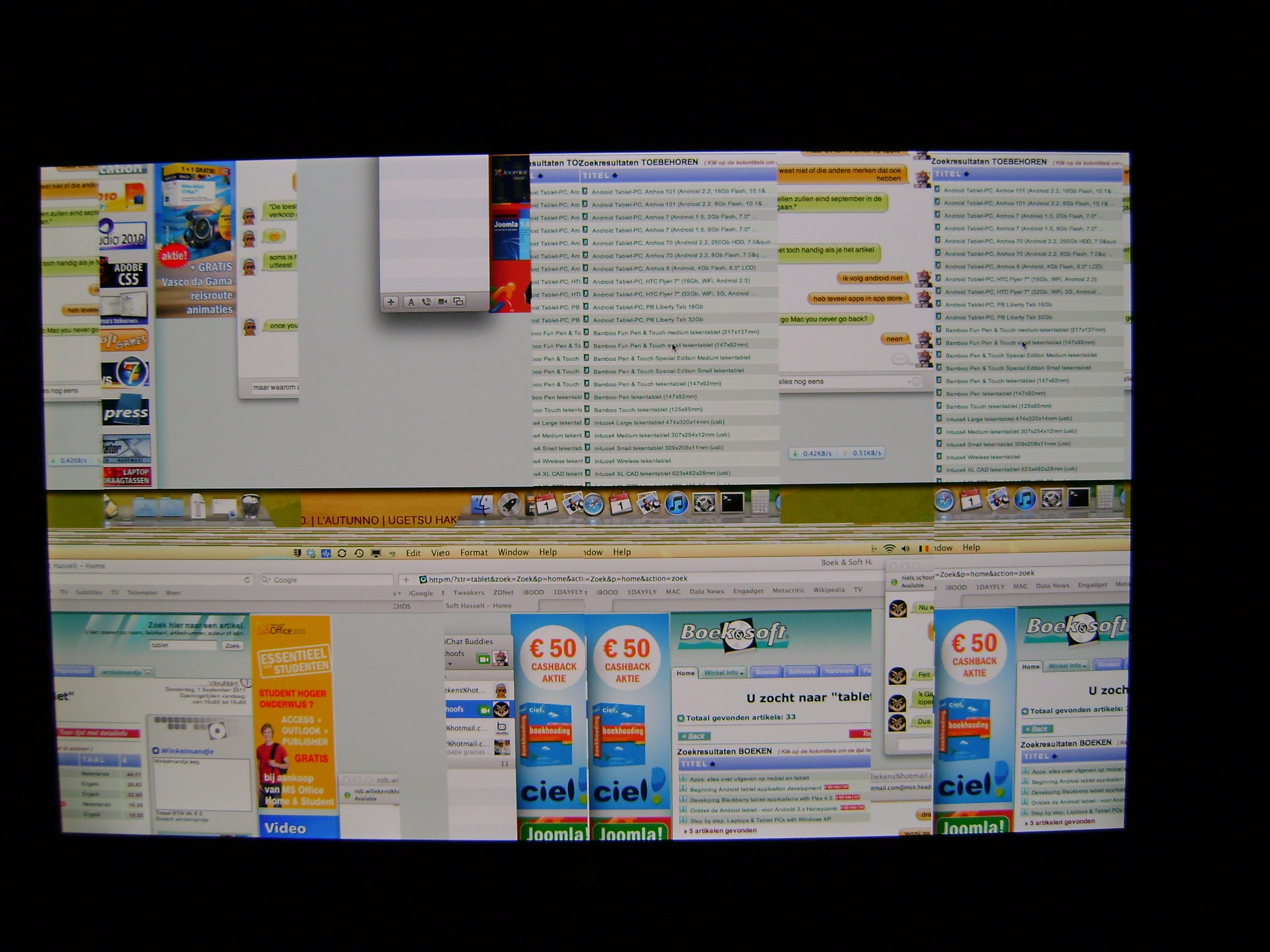

I've got the same problem. I have a Mac Mini with the 6630 GPU and a 24 inch Apple Cinema Display connected.
I used to have a MacBookPro running Lion connected with the ACD without any problem. I've sold the MBPro and replaced it with the new Mac Mini and that's when the problems started. I get without any reason a black screen for about a second and this happens every 2 - 15 minutes.
Once I had a completely distorted screen, where the corners appeared in the middle of the screen. I was able to continue typing and using the mouse, but the center of the screen had moved (see attachment).
Is Apple going to fix this problem or will I have to return the Mini?
