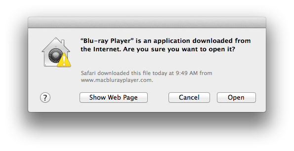

And now I've remembered what quarantine is; it's the thing that stops downloaded apps from running until you explicitly approve them. I can't explain why you didn't get a confirmation prompt to bypass it though...
Edit: This one:
Edit: This one:
Yes - I thought it was related to that. The confusing part is the attribute wasn't on the app - or even the folder or volume. It was on the .dmg file that held the volume/folder/app which is why I didn't see it when I was searching.
