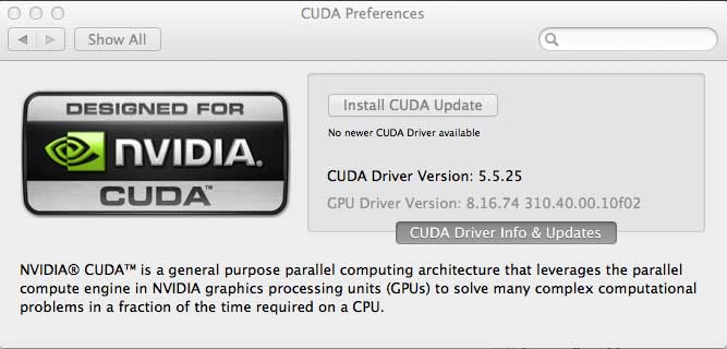

Do you have the nVidia CUDA libraries and panel installed? If so, open up the panel. It'll tell you what the driver's version is.
Nvidia Driver is shown in Cuda Panel in System Preferences.
Lou

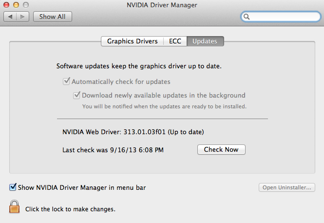

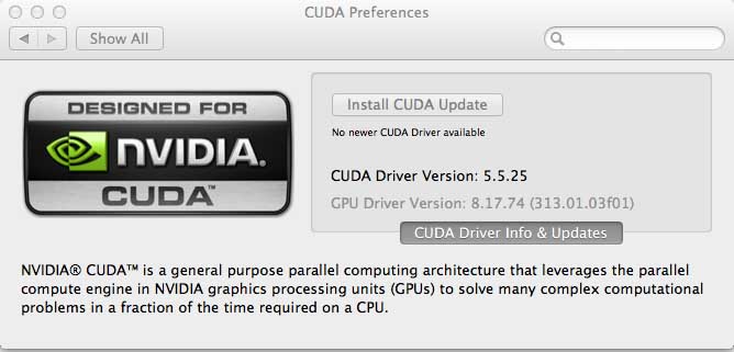

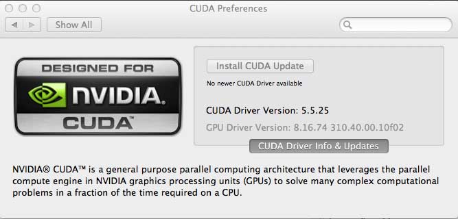

CUDA panel in OS X 10.8.5 reports:
CUDA Driver Version 5.5.25
GPU Driver Version: 8.16.74 310.40.00.10f02
NVIDIA Driver Manager panel reports:
NVIDIA Web Driver 313.01.02f01 (not compatible)
As I was reporting this information, just checked (again) and a new NVIDIA Web Driver became available: 313.01.03f01. This was not available this AM. Will install shortly and report if there are any issues.

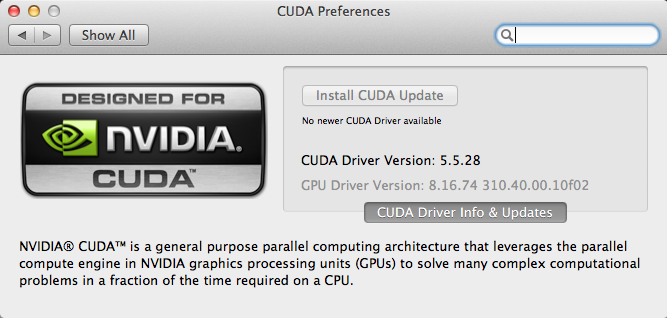

Just installed in the Nvidia Web Driver. See the difference in the screen shots of the Cuda System Preferences Panel?
First one is Apple's OS Driver
Second One is Nvidia's Web Driver
BTW, Don't use the link above. I tried to install from that, and had to erase and clone my StartUp disk from a BackUp😡
I got an on screen message from Nvidia saying a new driver was available, did I want to install it? I installed from there.

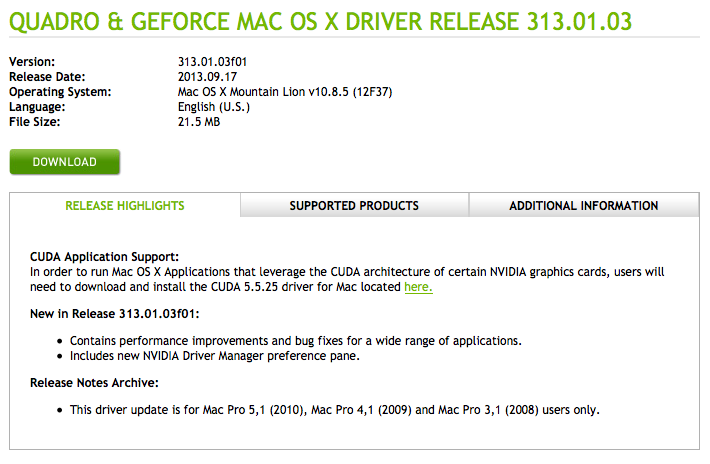

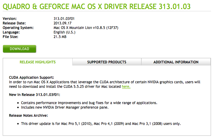

Yeah, web page for the 10.8.5 driver is live now:
http://www.nvidia.com/object/macosx-313.01.03f01-driver.html
Looks like everything got rolled out last night.

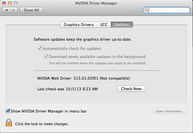

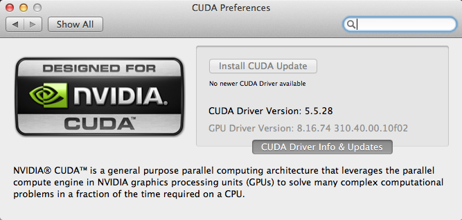

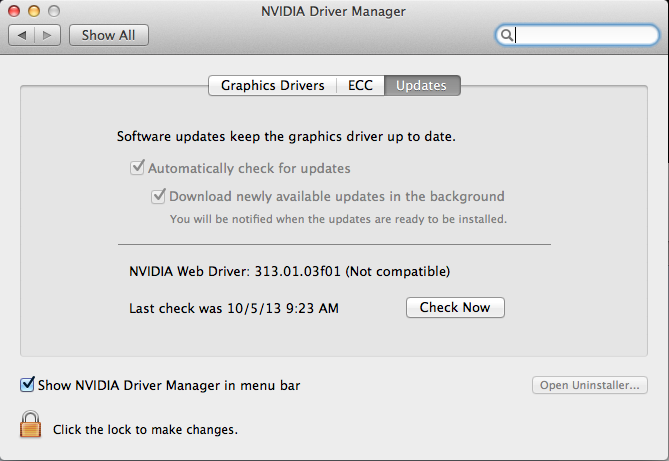

Just a head's up to all - the 10.8.5 supplemental update breaks the NVIDIA driver manager, again. The latest 313.01.03f01 is NOT compatible after installing the latest OSX update - learned this after it was accidentally installed on a machine I was working on...
There was a new CUDA update, however - now on 5.5.28, and nothing that appears to have been impacted from this update.
Will wait a week or so before I decide to resort back to a clone on this machine or not. Maybe an updated driver will become available by then?
Just to clear up a bit of confusion here, based on the wording of your message.
The NVIDIA driver manager is not broken, it is doing its job perfectly well. The NVIDIA web driver is tied to a specific version of the Apple OpenGL framework, i.e. a specific version of the OS (in this case 10.8.5 12F37). If Apple updates the OS and rolls out a supplemental update (to 12F45 or whatever it is) there is no guarantee that the original NVIDIA web driver will continue to work with the new version of the OpenGL framework. Thus, the NVIDIA driver manager reverts back to the stock Apple drivers and lets you know that has disabled the web driver until an update is released.
It's basically the same thing that happens when you update from 10.8.4 to 10.8.5 -- the old web driver won't work with the new version of the OS, so it gets disabled until an update to match the new OS is released. I'd expect a new driver to be released any day now, based on NVIDIA's history of web driver releases.

Sorry about the wording - didn't mean to cause any confusion. Just wanted to alert anyone who was installing the update that the Nvidia web driver wasn't working at that time...
The updated driver was installed (successfully) on the machine this evening and is now running 313.01.03f02 and is up to date. Installed through the driver manager. Not sure if it is available for download directly yet, but I've been installing through the driver manager for several versions now without a problem.
Latest CUDA is still 5.5.28 in case anyone wanted to know.
No worries, this appears to be a common misconception. Now that the NVIDIA web driver doesn't clobber the stock Apple driver (i.e. gets installed in addition to the Apple driver), it basically has to disable itself if there is a mismatch with the OS version. It seems as if the wording of the dialog box that pops up when this mismatch is detected freaks people out or something.
