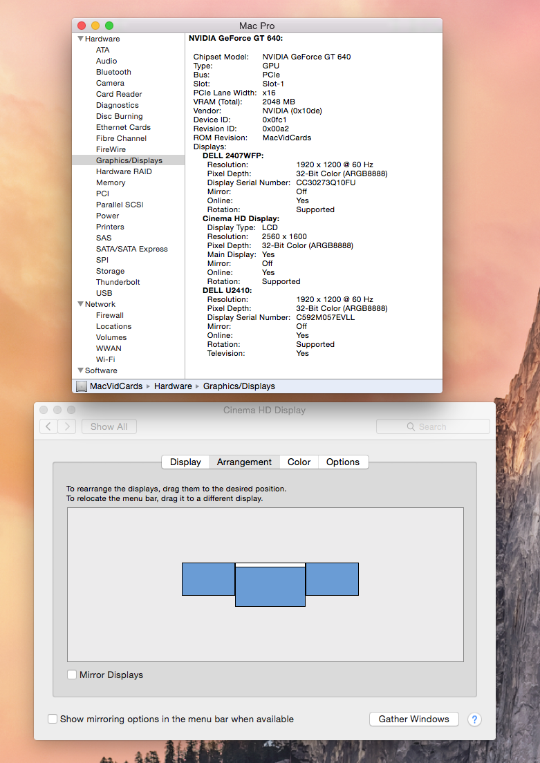

GT640 issue solved !!!
We introduced Gt640 with EFI during 10.8.3 days.
Cards worked perfectly up through 10.9.2
In 10.9.3 a nasty surprise happened, they suddenly had 2 ghost monitors and only 1 functional port.
I enlisted the assistance of my friend in Russia and we got to the bottom of it. (Had a hint from elsewhere as well)
Anyhow, any and all past customers can have free update, please contact us via website. You will need Ebay or website sales number. Will require return and reflash for most.
Back to running 3 displays, tested in 10.9.4 and 10.10 DP5.
I apologize to all of the patient people who's nifty triple display single slot no-power-needed cards become crippled by 10.9.3.
Not sure why the driver change happened or who made the BIOS error, but we have figured it out. (BIOS error existed in part of rom we DON'T usually fiddle with)
As usual, thanks to our Green friends in San Jose who keep writing drivers for us even though Apple has shoved them out of the nMP party (for now)
