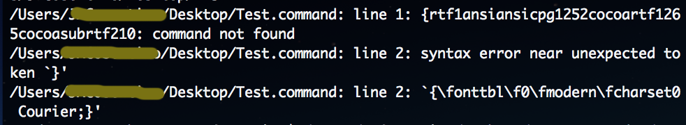

Okay. I added the space and followed your instructions. The first enter just went to a new terminal command.
Then I dragged the bash (shell) file and then the test folder and got this after the second enter:

For starters it looks like you probably used rich text document. You need to make sure it's plain text otherwise there's hidden formatting.
Secondly a possible problem could be that potentially your quotation marks got auto formatted (probably just in textedit but maybe in automator as well) and thus wouldn't work. Make sure your quotes have not been made into smart quotes. All quotes should be " not like ” or ‟ or 〞.
