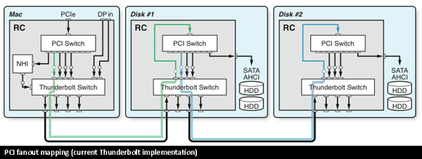

Does this diagram indicate that no Thunderbolt "traffic" is passed through the "Thunderbolt switch" without traversing the PCI switch? (I use quotes to help the strain on the terminology) Because in that case, the "Thunderbolt switch" is definitely not going to forward "Thunderbolt IP" traffic.
The other image on that site shows an alternative implementation diagram:
This looks more promising, but it seems like this implementation is theoretical at the moment. I think that this functionality would really change the TB/IP as it stands. Right now it seems to honestly be merely a novel file transfer protocol.

I did take a look at one of the links that you posted above and appreciated reading the epistle you wrote ;). However this diagram on one of the sites you linked has me scratching my head:
Yes. That's the way Apple/Intel currently implement it (using PCI fanout mapping instead of direct mapping). But this is an entirely different scenario because here you see one host controller (the one on the left) using daisy chaining with two other TB devices in endpoint mode.
IP over Thunderbolt is an implementation between two TB host controllers.

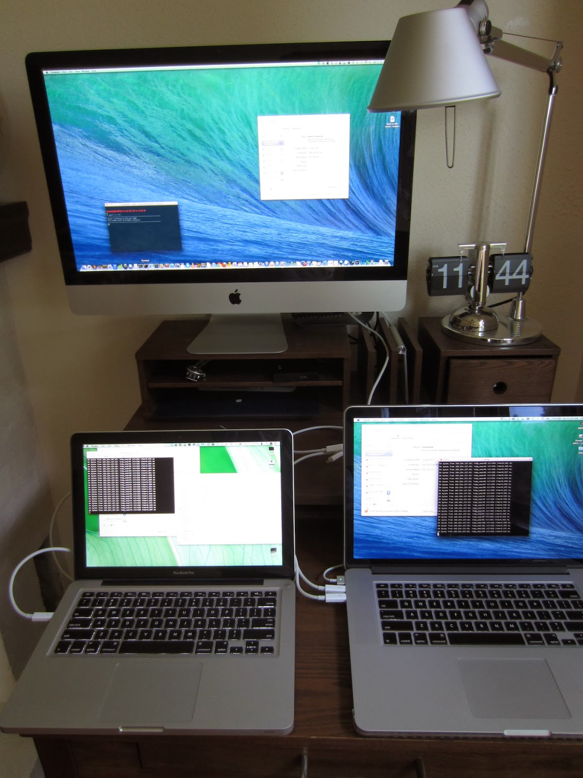

I tried 3-way Thunderbolt bridging.
13" Macbook and 27" iMac both connected to a 15" Retina (acting as a hub).
The 13" could easily see the 27" Imac which was on the other end.
There was a small degradation loss but it works. It is all plug-n-play. I did not have to do any routes or anything special to make the 13" see the iMac. It just worked.
This means a Thunderbolt switch/hub is in the realm of possibility.
First two iPerfs are 13" connecting to the imac.
Last two iPerfs are 13" connecting directly to the 15" Retina
IP addresses are re-assigned automatically when you plug and unplug Thunderbolt cable. E.G. I unplug the 13" from the 15" and re-connected to the iMac directly.
There is more, you can google my username and IP Thunderbolt to get more information.
