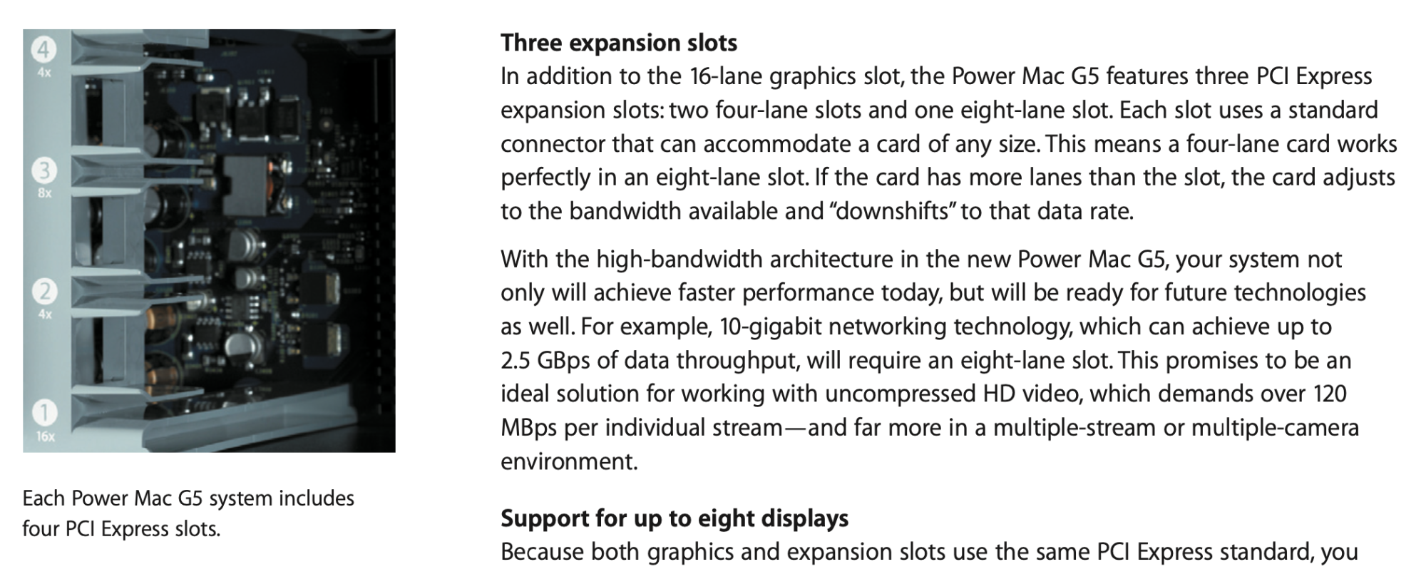

I think this is not true. Sonnet cards are supported on G5s and specs claim 6 Gbps. And real-life measurements seem to show a higher speed than 250 MB/s.
I meant 2 Gbps per lane. The Sonnet cards would need four lanes to get near 8 Gbps. You need 8 lanes to get the full 10 Gbps. Here's an 8 lane card https://www.sonnettech.com/product/presto10gbesfp.html but the Quad G5 has only one slot that supports 8 lanes and that is usually used by the GPU. Maybe you can move the GPU and the 10GbE card to an external expansion box like the Netstor NA255A. The NA255A can probably convert the PCIe gen 1 x8 of the G5 to gen 2 or gen 3 so an x4 card would be sufficient. But that is super expensive and there's no Mac OS X PowerPC 10GbE driver yet.

Let's try to analyze the situation.
First, the software: If you wanna use this ethernet card on OSX you'll need drivers like many already said here. In Linux it's most certain that it would work.
Second, the hardware: You need to pay attention to the limitations of the technology available at the time, so according to one post from last year (assuming the target machine for the card it's a G5 Quad)
Quad G5 has:
- two x4 slots: ≈800 MB/s
- one x8 slot: ≈1600 MB/s
- one x16 slot: ≈3500 MB/s
And theoretically an 10Gb ethetnet card can throughput 1250Mb/s at peak. So the "right" slot should be the x8? (I know that it's not, but let's keep the numbers to give the best scenario possible)
