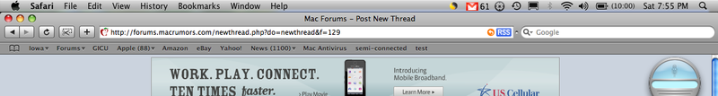

So my macbook keeps telling me there is 10 hours left before the battery dies and 100% of the battery left. This is not after waking it up or waking the screen up after its been sitting. I have tried restarting my computer and it still does it. Any ideas?

The percentage and the time never change as the battery is drained?

Totally unrelated, but you need to get rid of Norton Antivirus.

haha yeah I don't even know why i have it on my computer, just haven't gotten around to taking it off I guess. I have iAntivirus running instead.
