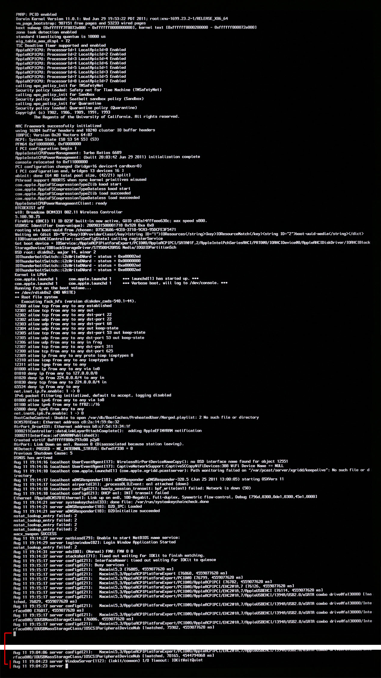

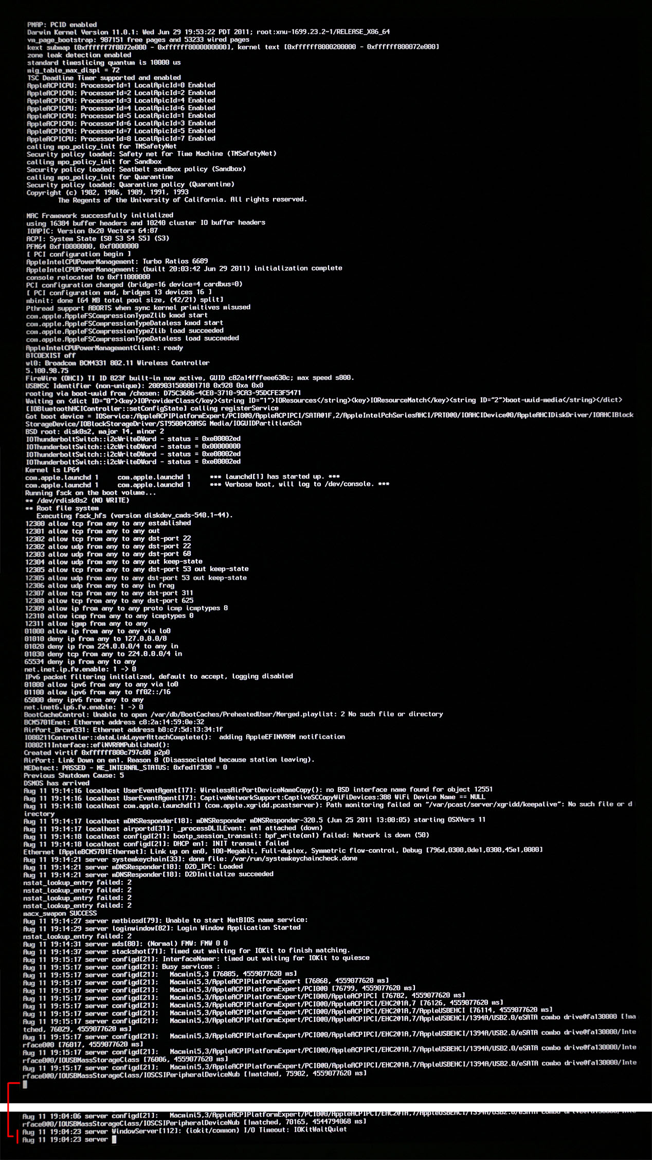

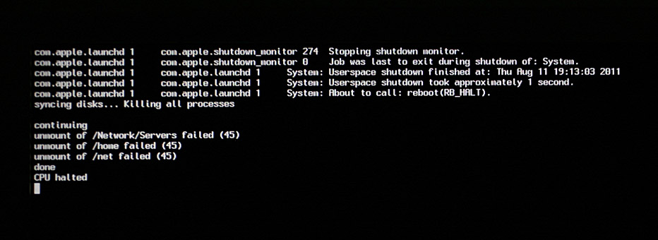

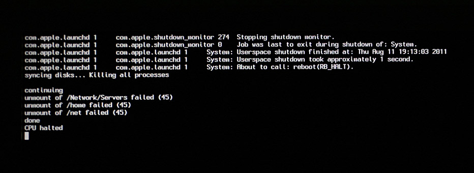

OK, started up in verbose mode and took pictures of the text as is scrolled by before the blue screen came up. Attached is the login text and the shutdown text. On the login, I forgot to grab two lines from one startup but grabbed it from privies login. I can't recall if they were identical, but I suspect they were as they looked the same size and it was only two lines. This didn't take too long, maybe a minute and then there was 9 more of waiting...
If anyone has any ideas, I'd be tickled. I am pretty clueless as to what this exactly means nor am I able to identify any specific problems from this. SO, if no solution here, it is off to the Genius Bar...
